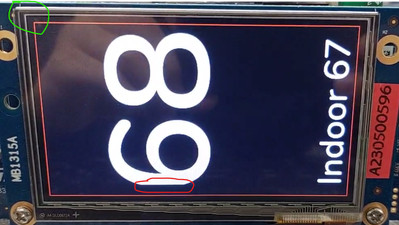

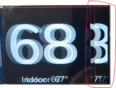

I am a beginner with TouchGFX. I created two screens with a slide transition and found some questions would like to confirm.

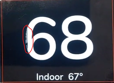

1) Text broken
I found that when the B screen transitions to the A screen, the Big Text contains text broken during transition and is recoverable.
CPU frequency = 280MHz (recoverable) (00:00:07, with 0.25 speed)
video link: https://drive.google.com/file/d/1CLOdeWr4uZ_r9ffi9f0Zoa8mLxGHqC14/view?usp=sharing
Contains Black pixels

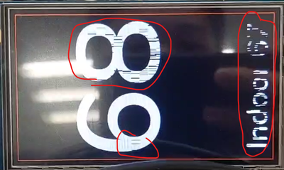

CPU frequency = 160MHz (irrecoverable)
video link: https://drive.google.com/file/d/1GZGT-tRYJ5CKWq-NUqbRcbQ5Ftn7lW1n/view?usp=drive_link
Text pixels always missing after transition
  • How the CPU frequency influence this issue?
  • Could it be fixed if using double buffer for TouchGFX?
2) Animation Storage
According to the instructions, I should set a full-screen size buffer for the animation storage. However, I set the half-buffer since out of RAM resources.
(00:00:03)
  • I would like to confirm that this issue would be fixed when the animation buffer is full-screen size?

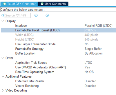

Info:
MCU: STM32H7B3VIT
LTDC: RGB56
LCD: 480 * 640
TouchGFX:
Please let me know if more information is required.

  1. I think the screen rotation is applied since (0,0) should be the Right Top corner (Green circle), and Display setting is Landscape for the above-mentions scenarios.TesterSAM_1-1760590413079.png
  2. TouchGFX version 4.26.0
  3. Yes, it is using the single buffer of the Framebuffer Strategy setting.
  4. Half Animation storage applied to the above-mentioned scenarios.
  5. Using STM32H7B3LI-DK with full-screen size Animation storage, the slide transition is perfect.
  6. If the rotation is necessary, any solution to improve the Text broken issue? could GPU2D help?

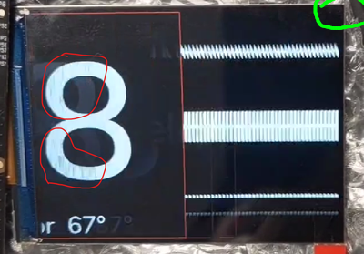

The Text broken issue persists when using STM32H7B3LI-DK with
  • Single Buffer
  • Full Animation storage (480*272)
  • Enabled DMA2D
  • Portrait Display Setting
Result: Green circle should be (0,0),  Red circle = Text broken
Video Link : https://drive.google.com/file/d/1FAWcwHx9w8S6NeeVPPbVY8C7fTd5gpfd/view?usp=drive_link
(00:00:07 - 00:00:08)

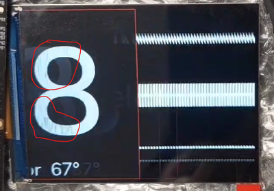

If using Double Buffer in STM32H7B3LI-DK, the Text broken issue get worse
  • Double Buffer
  • Enabled DMA2D
Result:
Video link: https://drive.google.com/file/d/15-Mind9sM58tjA37XuyQ8eQiG7wSqEj3/view?usp=sharing
I only updated the Framebuffer Strategy setting. Is that any missing configuration?
By the test:
  • Slide Transition is smoothly if using full-screen animation Storage
  • the Text Broken issue still exits. Maybe due to rotation issue, I will test later.
  • Any idea to handle the Text broken issue if the Display rotation is necessary?
