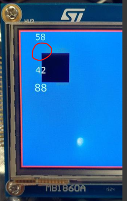

How to create a Bitmap Data with Font/image's content without a noisy background?
STM32U5G9-DK Result (noise for the Background):
Simulator Result (expected):

Ok, then you need to use an auxiliary LCD32 to render the dynamic bit. I can see that you already tried to add this to your project in FrontendApplication, but maybe you where missing this important line (since your dynamic bitmap content is a texture mapper):
lcd32.enableTextureMapperAll();

The noise you see in the dynamic bitmaps comes from the memory not being initialized. You can e.g. fix this by inserting the following between line 4 and 5 in your code snippet above:
memset((void*)TestFont1Bitmap.getData(), 0, TestFont1Bitmap.getWidth() * TestFont1Bitmap.getHeight() * 4);
Be aware that you might see another glitch (with the text characters being "scrambled") when reprogramming a running board. This can be solved by power-cycling the board or by inserting the following code to the last user code section of MX_DCACHE2_Init function in main.c:

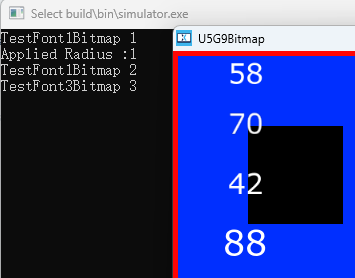

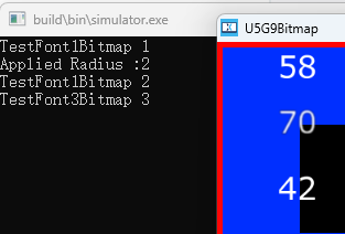

I got another issue that I tried to apply a Blur function to the Bitmap data, the simulator could review the result, but the Hardware failed.
Any idea about this issue?
Any Demo/ Example that applied a filter effect to the Bitmap Data?
Any plan to add a built-in filter feature in TouchGFX in the feature?
STM32U5G9-DK result:
Missing TextureMapper "FontTM"
Radius = 2Triggered HardFault
Simulator result:
Normal
Normal

I can see that you have an issue with your tempBuffer:
uint8_t* tempBuffer = new uint8_t[width * height * 4];
This requires 10000 bytes, but you have only allocated 0x200 bytes for heap in your linker script:
_Min_Heap_Size = 0x4000; /* required amount of heap */
As a result your tempBuffer overlaps with your bitmapCacheBuffer, and the dynamic bitmap adresses are therefore corrupted. You could try to make your heap large enough or use static allocation for your tempBuffer.

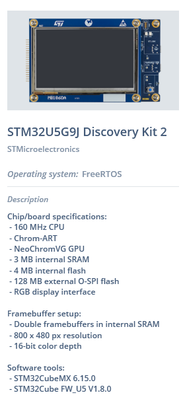

You need your dynamic bitmap to be ARGB8888 to handle the transparency, but you can set your framebuffer color depth independent of this. TouchGFX framework, ChromART and NeoChrom will handle the conversion between the format of your bitmaps and your framebuffer.
It rarely makes sense to set the framebuffer format to ARGB8888, since you rarely need your actual framebuffer to have transparency. So you can reduce the framebuffer RAM size to 75% by switching the framebuffer format (LTDC layer 0 format) to RGB888 without any loss of quality. You can also (like you suggest) reduce the framebuffer RAM size to 50% by changing to RGB565, but can lead to some display banding because of the reduced color space.
You can take a look at the TouchGFX Board Setup that we provide in TouchGFX Designer "Create" menu. This is set up to use RGB565 double framebuffer:

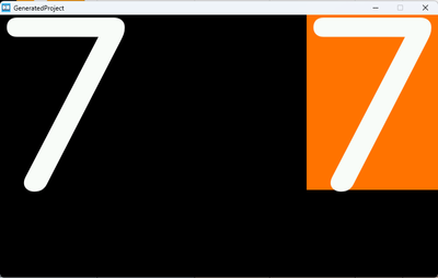

The Container & Bitmap setup code:
void Case4CusContainer::initialize()
    Case4CusContainerBase::initialize();
    touchgfx_printf("TouchGFX Project case2\n");
    SetupBitmap();
void  Case4CusContainer::SetupBitmap()
	ImageBitmap = Bitmap::dynamicBitmapCreate(240, 325, Bitmap::ARGB8888);
	touchgfx_printf("ImageBitmap :%d\n", ImageBitmap);
	if(ImageBitmap != BITMAP_INVALID)
		uint8_t* const bitmapPixels = (uint8_t*)Bitmap::dynamicBitmapGetAddress(ImageBitmap);
		memset(bitmapPixels, 0, ImageBitmap.getWidth() * ImageBitmap.getHeight() * 2);	// HW Fixed Noise Background issue
		HAL::getInstance()->drawDrawableInDynamicBitmap(ImageTM, ImageBitmap);
		BitmapTM.setBitmap(ImageBitmap);
		BitmapTM.setPosition(560, 0, 240, 325);
		BitmapTM.setBitmapPosition(0, 0);
		BitmapTM.setupAnimation(AnimationTextureMapper::SCALE, 1.0f, 0, 0, EasingEquations::linearEaseInOut);
		BitmapTM.startAnimation();
My expected Result would be:
1. Copy the Image TextureMapper content, and convert into ARGB8888 Bitmap format, and place it into the a new Texture Mapper.
2. Set the new Texture Mapper location on Top of the orange region.
Here is my test result:
 LTDC ConfigTouchGFXDynamic BitmapResult
casePixel ParametersFrambuffer Pixel FormatFrambuffer StrategyBuffer LocationFormatSimHW
1RGB565RGB565Double BufferBy AllocationARGB8888Fail (no "7" display on top of the orange region)Fail (no "7" display on top of the orange region)
2ARGB8888ARGB8888Singal Buffer (RAM resouce)By AllocationARGB8888Matched to my expected resultMatched to my expected result
It is failure to show the ARGB8888 Dynamic Bitmap Data under RGB565 pixel parameters config in LTDC.
Please found the attached files for reference.
