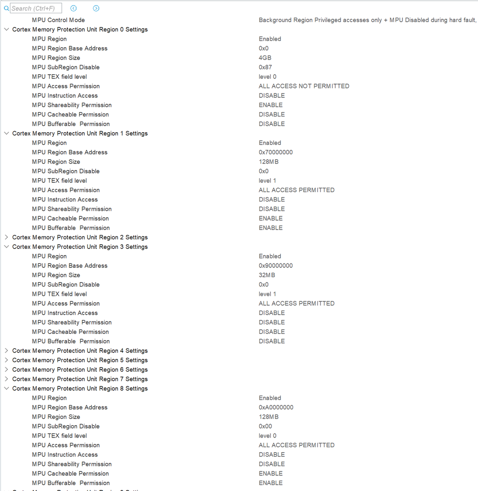

I was not aware you were running an H7S78. I think your original problem is probably related to MPU settings. For that template project, a base region is set up to allow no access to all areas, and regions are then set up on top of that to allow acces to specific regions. You should create a region for your SD address space with the settings used for region 1.
I believe we are almost here. Thanks.
So I changed the priority of the Timer and the SDMMC1 init now is ok.
I tried to also add a new address space for my SD (Region 8) according to the next image :
I can't see any image on the screen yet. The program is running without error.

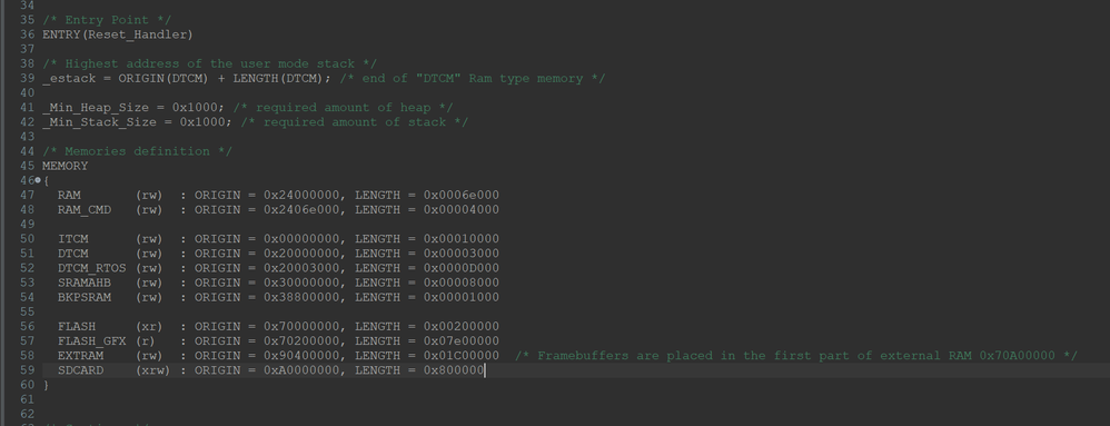

This is also my linker file :
Thanks for your help @mathiasmarkussen

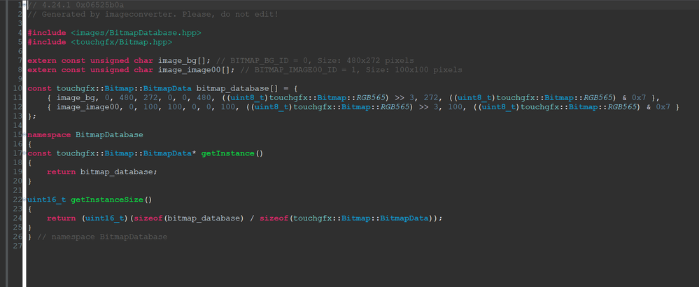

// 4.24.1 0x06525b0a
// Generated by imageconverter. Please, do not edit!
#include <images/BitmapDatabase.hpp>
#include <touchgfx/Bitmap.hpp>
extern const unsigned char image_bg[]; // BITMAP_BG_ID = 0, Size: 480x272 pixels
extern const unsigned char image_image00[]; // BITMAP_IMAGE00_ID = 1, Size: 100x100 pixels
const touchgfx::Bitmap::BitmapData bitmap_database[] = {
    { image_bg, 0, 480, 272, 0, 0, 480, ((uint8_t)touchgfx::Bitmap::RGB565) >> 3, 272, ((uint8_t)touchgfx::Bitmap::RGB565) & 0x7 },
    { image_image00, 0, 100, 100, 0, 0, 100, ((uint8_t)touchgfx::Bitmap::RGB565) >> 3, 100, ((uint8_t)touchgfx::Bitmap::RGB565) & 0x7 }
namespace BitmapDatabase
const touchgfx::Bitmap::BitmapData* getInstance()
    return bitmap_database;
uint16_t getInstanceSize()
    return (uint16_t)(sizeof(bitmap_database) / sizeof(touchgfx::Bitmap::BitmapData));
} // namespace BitmapDatabase
This is my BitmapDatabase.cpp
