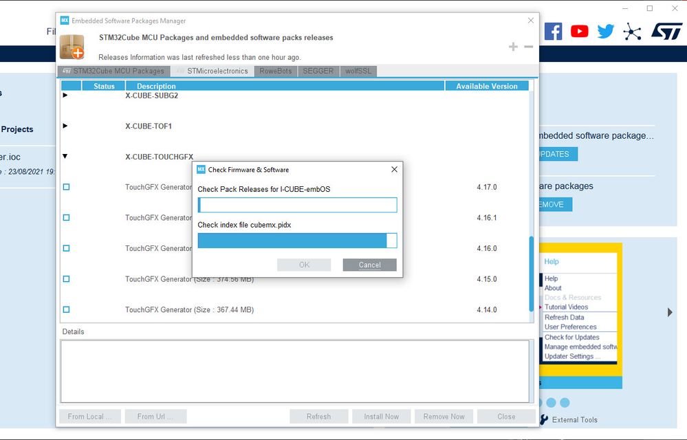

Hi. I've followed the installation guidance found at https://support.touchgfx.com/docs/introduction/installation and can't get TouchGFX 4.18 to show up in neither STM32CudeIDE and STM32CudeMX (refreshed several times). Will this show up when an update list gets updated or is this a permanent removal from the ST's IDE toolchain? Thanks

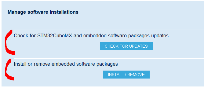

But I just thought of something. From the initial screenshot you shared you were looking at the "Install or remove embedded software packages" option. But did you go to the "Check for STM32CubeMX and embedded software package updates" before ?
0693W00000FDrrxQAD.pngIt is necessary to install the update first to then be able to install the package (which I find a bit strange, it should be something to see in the INSTALL/REMOVE option as well to avoid missing an update)

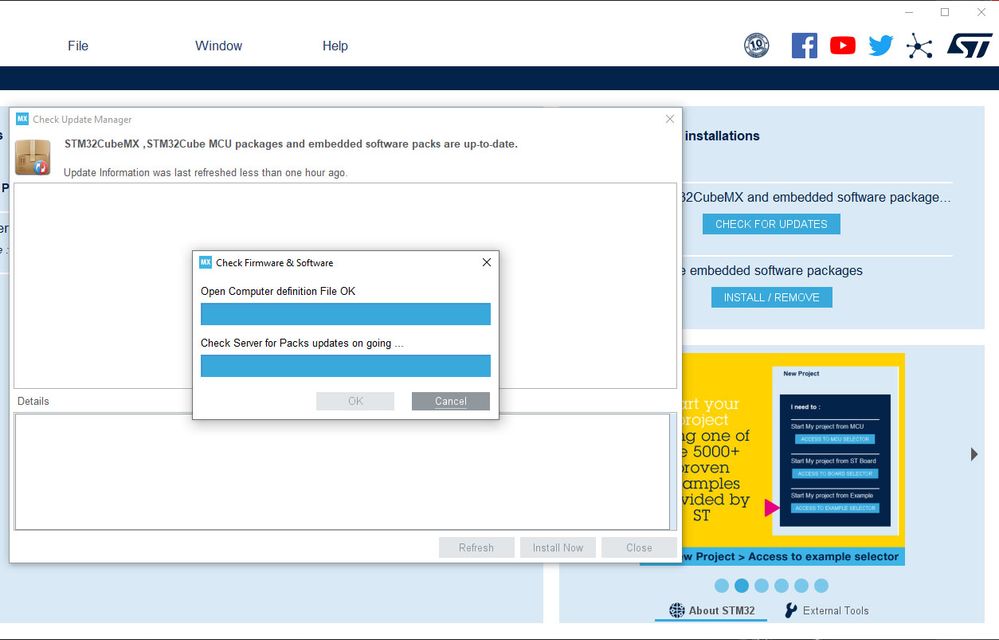

All updating/refresh services connects properly and appears to update (as per visual below). I can confirm that the problem persist though, TouchGFX 4.18.0 for instance never shows up. Let me know if you need me to check something else e.g. another package update, or whether I'm good to go in uninstalling this entire environment, clean the PC and start over from scratch.
