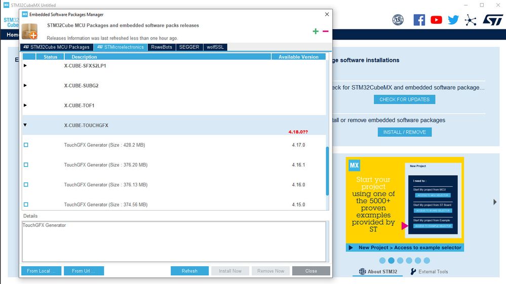

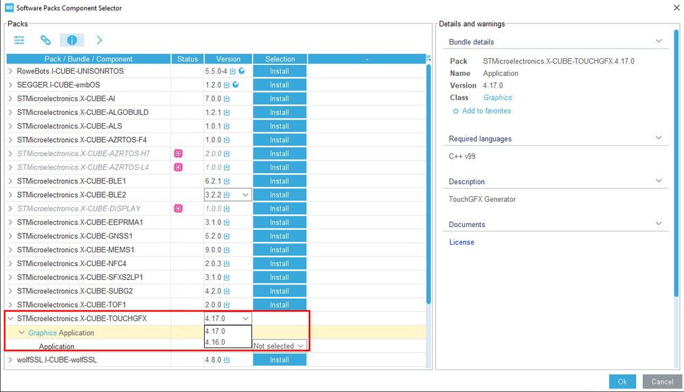

Hi. I've followed the installation guidance found at https://support.touchgfx.com/docs/introduction/installation and can't get TouchGFX 4.18 to show up in neither STM32CudeIDE and STM32CudeMX (refreshed several times). Will this show up when an update list gets updated or is this a permanent removal from the ST's IDE toolchain? Thanks

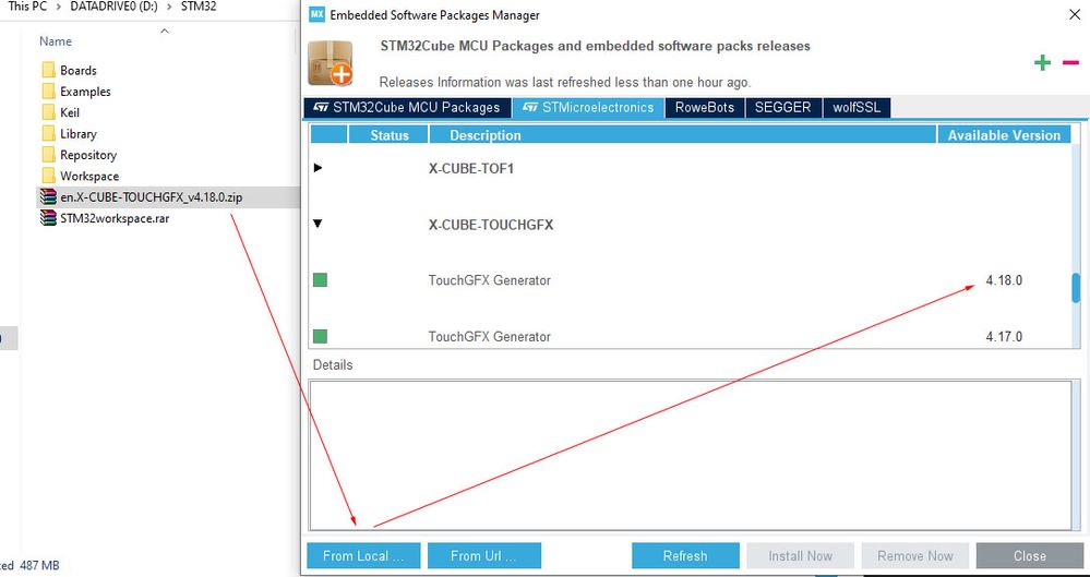

Try to import the zip file manually. You just need to click on "From Local" and then select the zip file that you downloaded from https://www.st.com/en/embedded-software/x-cube-touchgfx.html

I am able to see it on my side this is surprising. What version of STM32CubeMX are you using ?

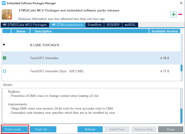

You can always download it from ST's website and use the "From Local" option in the bottom left of your screenshot to install TouchGFX 4.18.0

I'm having the same issue.
Tried refresh updates from STM32CubeIDE V1.7.0 and STMCubeMX V6.3.0 but TouchGFX V4.18 is not showing up.
As Sara wrote try to install TouchGFX .18.0 manually. I do not believe it is necessary to uninstall and install the environment again.

Thank you for the guidance Sara. Worked perfectly.

*Note*
After a manual From Local install; and if you can't find the 4.18.0 listed as per visual, initiate a Refresh from the active window, close CubeIDE/MX, and restart the session. Should appear at next start...
