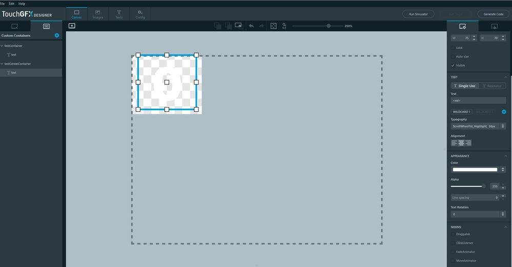

‎2020-12-16 8:49 AM
Thank you for your very fast reply. I created a custom container and in the "Text-line", I used a wildcard instead one text or multiple complicated structure, as you suggested.
I already used this custom contaier as a Item template in scrollwheel widgest as you suggested.
The issue is more, that I cannot/don't know how to initialize these values in the STM32CubeIDE.
