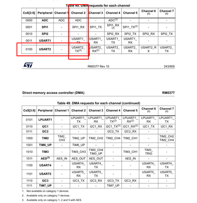

I'm trying to program an STM32L011F4 to transmit data through USART2 by way of the DMA controller.  My code compiles but the IRQ handler for DMA is never called.  Either I have not correctly initialized the DMA controller or there is another problem I am overlooking.  Can anyone provide suggestions?

You have to set DMA_CSELR.C2S = 0b0100 to map the USART2_TX request to DMA1_Channel2 (your STM32 model is Cat.1, right?)
That was it, the code now works correctly.  Thanks for pointing out what I had overlooked.
I had read that section of the manual several times but thought it wasn't required because I was transmitting and not receiving data on the usart.
