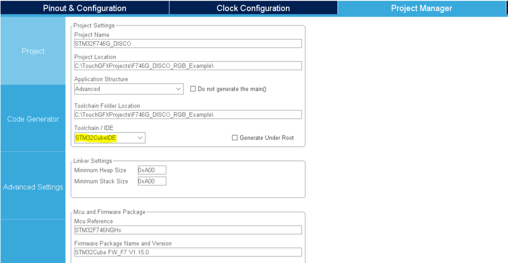

This is because you didn't set the correct IDE in CubeMX. By default, if you chose the Application Template available in TouchGFX Designer, the IDE is CubeIDE. Therefore you can only run target or build with CubeIDE. If you want to use Keil, you need to open .ioc file in CubeMX, go to Project Manager and change the IDE to MDK-ARM. Then generate code, go back to Designer and generate code from Designer. Now you can open and build with Keil.
