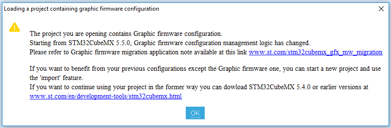

When I tried to open my existing project for the first time in CubeMX 5.5.0, it gives me a pop up window (See attached)
But I can't click the link that is refered in the window "Stm32cubemx_gfx_mw_migration) note.

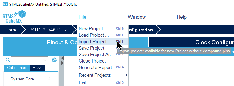

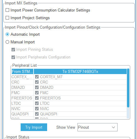

This message instructs you to “import�? the Peripheral Configuration of the 5.4.0 project from a new CubeMX 5.5.0 using the same STM32 Micro Controller as the 5.4.0 project (A warning will be issued otherwise).
Navigate to the 5.4.0 project using the Import function after which a list of available Peripherals is presented. Once the desired peripheral configurations are imported, follow the instructions for either TouchGFX or STemWin in the sections below.

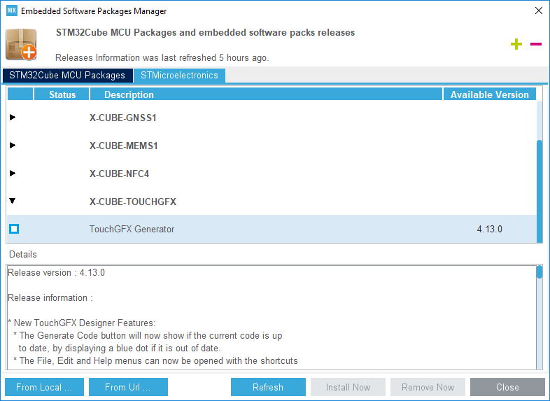

After importing the peripheral configuration install the X-CUBE-TOUCHGFX package from “Help�? -> �?Manage Embedded Software Packages�?, STMicroelectronics tab. See the article on Installing TouchGFX for further details.
