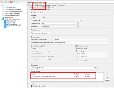

Add that flash loader in the Debugger/ External loaders:
I have done that. I have created the 'External Loader' and I have proven it works and writes/reads to QUADSPI at memory region 0x90000000, using STM32CubeProgrammer. As shown in the Youtube tutorial.
I then added it to STM32CubeIDE
However, your linker script that you have provided refers to '
  BOOTLOADER   (xrw)    : ORIGIN = 0x08000000,   LENGTH = 128k
Located at:
