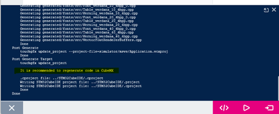

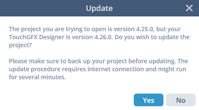

When you update your project you should see these messages :
  • When you open the project with TouchGFX Designer :
  • When you generate code from TouchGFX Designer:
    If you open the ioc file with the latest STM32CubeMX, you'll be asked to update the firmware (if a most recent one exists).
