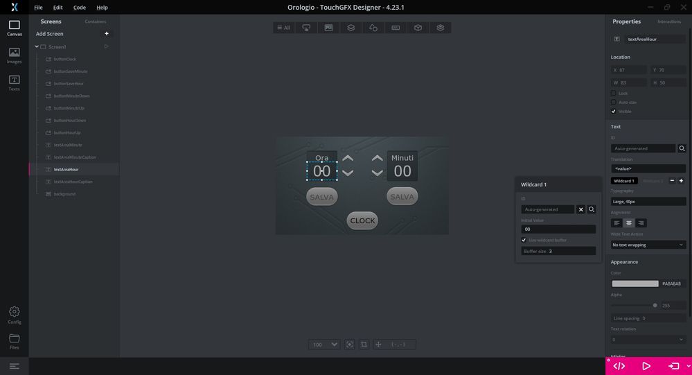

Good morning , sorry if i'm not posting in the right place but i'm still learning. I have a problem with an example i saw in the tutorial where you bild an iterface to adjust the hour and minutes . In the tutorial where i built the interface it says to copy the code and put it in two files .... i tired but when i press the buttons mothing happens and in the two text areas thereare two question marks. Could someone kindly help me? Thank you so much.

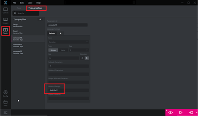

The issue there is that you added a wildcard but did not specify the characters this wildcard can take.
You need to specify which characters can take by going into "Texts", "Typographies" and than filling the fields "Wildcard ranges" for example :
In this case my wildcard could take all the ASCII values.
In your case you just need numbers do you could either type "0,1,2,3,4,5,6,7,8,9" or "0x30-0x39".
