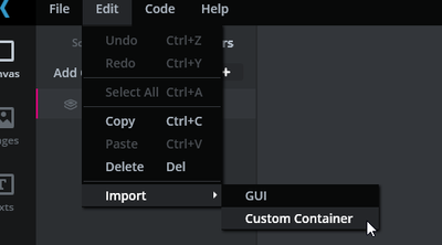

 If I can I still take advantage of the availability. Can I make it so that this clock can also be used in other applications without having to build it all the time in each new project? Thanks
Yes you can do that.

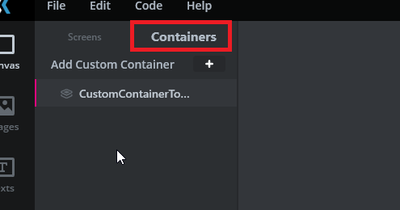

You will have to create a custom container (also called a custom widget) : custom widgets

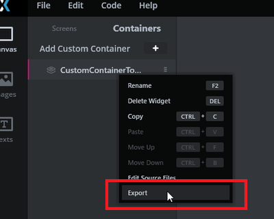

To do so, you basically have to create your clock inside a custom container :
Once you are done, right click on the name of your custom container and click export :
Make sure to change the name of the typography you will use (don't keep it called "default") otherwise you will have errors when importing it from another project.
Once you exported your custom container, it will be saved as a .tpkg file in your project's folder.
Finally, you can import it in another project by clicking edit, import and then custom container :

ok thanks a lot. I'll try
 You are really very prepared...... you already know all the problems I will face. I already noticed that I had to change the names in the typography. I noticed that when I launch the simulator in the custom container I have no errors but the screen remains black. if I export it and then import it into a project it shows correctly. Is this normal, am I doing something wrong? Thanks so much and have a good day
