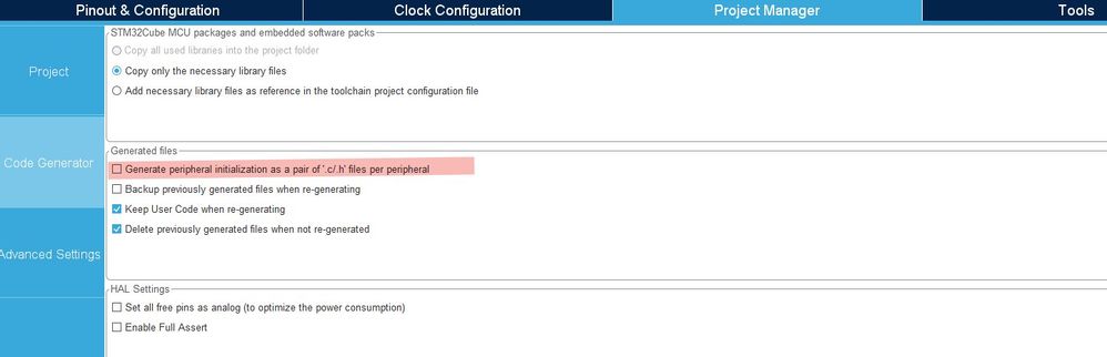

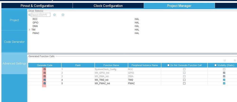

I was mainly wondering if there's some configuration somewhere like "don't generate this file",
really? because you never asked that question. There are some knobs for controlling some of that, for peripherals.
Also "don't generate" is quite easy to do by just deleting with a post-generation script. if that's what you mean.
