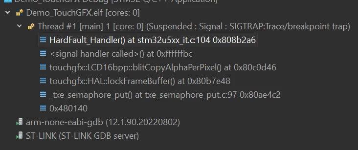

I'm working on a custom STM32U5 board with TouchGFX. The board features an external NOR flash memory used for storing the ExtFlashSection (as documented here).
In my project testing, I aim to display a simple black and white image with a transparent area. Initially, I configured TouchGFX Designer to place both the "Section" and "Extra Section" within the internal flash (IntFlashSection), and everything functioned as expected. However, my application necessitates storing media files in the external memory.
To achieve this, I successfully linked the ExtFlashSection to the external NOR flash. Subsequently, I modified the positions of both the "Section" and "Extra Section" from IntFlashSection to ExtFlashSection.

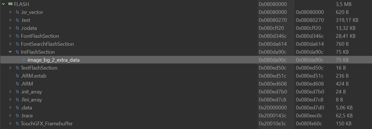

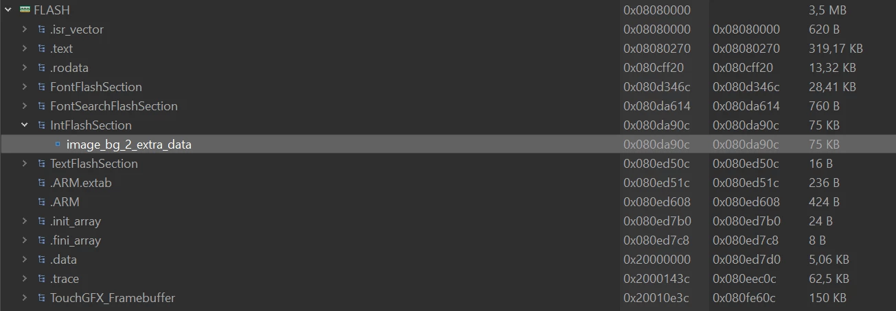

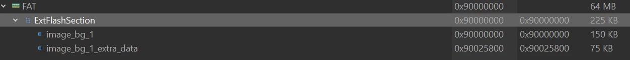

after compilation this my external memory:

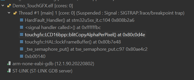

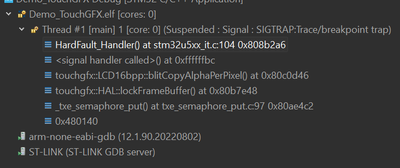

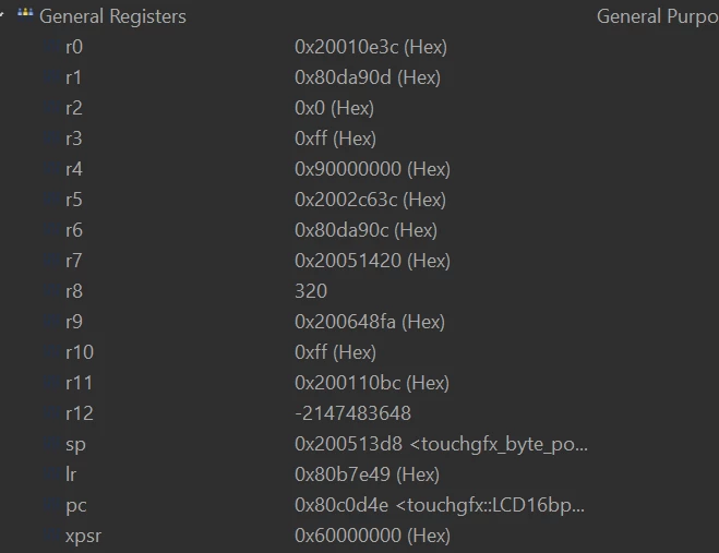

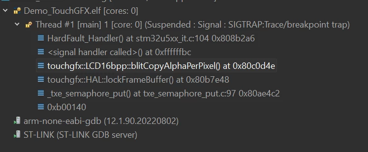

When running the code, a hard fault occurs. This is likely due to TouchGFX attempting to directly fetch data from external memory during the loading of the "Extra Section" data, instead of using the BlockCopy function.
This is the Trace:
And these are the registers:

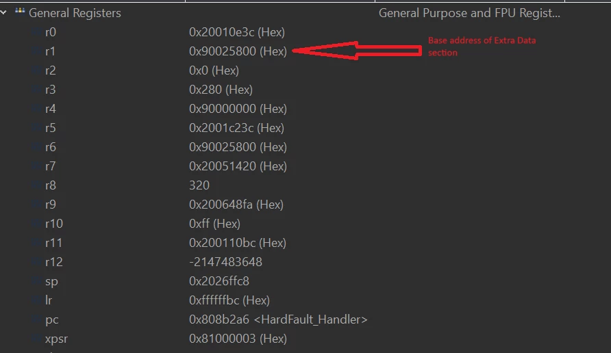

I came across this post and suspected it might be related to a known TouchGFX bug. I decided to move only the extra data to the IntFlashSection, which initially resolved the issue. However, when I tried changing the background image from bg_1.png to bg_2.png, a hard fault occurred again....here there are trace and registers
This time r1 is contains the base address for Extra Section of bg_2 in internal flash. So memory access should be ok....
What is the difference between bg_1.png and bg_2.png that could be causing this problem?
I would appreciate any suggestions or hints to resolve my problem.

Hello @Dadigno ,
From my understanding, SIGTRAP:Trace/breakpoint trap happens when the gdb (debugger used for embedded products) is not properly updated after using breakpoints.
Basically, you used breakpoints to debug your first problem which caused the current issue.
The solution seems to be to remove your breakpoints, disconnect the ST-Link, power off the board and reset everything.
If you restarted your computer from the time the issue happened it might have solved itself.
Please tell me if your issue is solved.

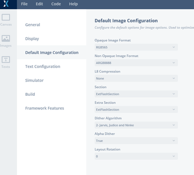

 - screenshot of your parameters in Designer :

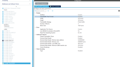

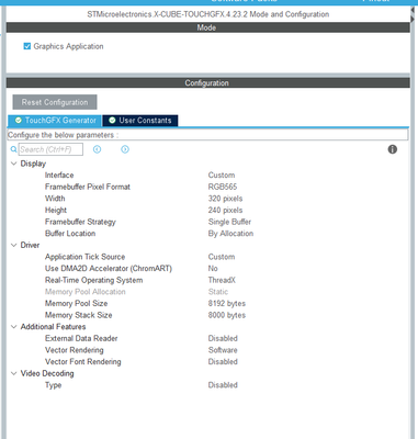

 - screenshot of you x-cube-touchgfx configuration in STM32CubeMX :

Hi Gaetan,  I've done even more tests to answer you, so now consider this situation:
1) Full black background (RGB565): no problems, it works both using internal memory or external flash throught my BlockCopy function.
2)  Black background with tranparency (any) (ARGB8888), as you mentioned:
  • Section int | extra section int => success
  • Section ext | extra section ext => hardfault
  • Section ext | extra section int=> hardfault
This is my block copy function:
bool TouchGFXHAL::blockCopy(void* RESTRICT dest, const void* RESTRICT src, uint32_t numBytes)
 if ((uint32_t)src >= 0x90000000 && (uint32_t)src < 0x94000000)
 uint32_t dataOffset = (uint32_t)src - 0x90000000;
 char file_name[] = "media";
	uint32_t ret = fs_read_file(file_name, dataOffset, numBytes, ((uint8_t*)dest));
	if(ret == numBytes)
		return true;
	else{
		memset((uint8_t*)dest, 0, numBytes);
		return false;
 else
 return TouchGFXGeneratedHAL::blockCopy(dest, src, numBytes);

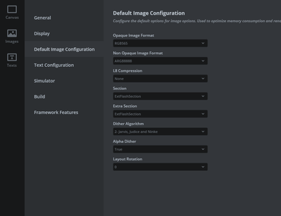

 This is my Designer configuration:
This is x-cube-touchgfx configuration in STM32CubeMX :
This is the image section:
The memory details:
The HardFault error:
Thanks again for your support

Can you try to change your images so that the black area is a color (ex: red) instead. Because, by default, the background of a TouchGFX is black. This will help us verify that everything worked properly when it does run correctly.
The extra section should be useless if not using L8. However, for image 1, your extra section is 75Kb. Can you check what those 75Kb are, what data is in there.
In your first post, you show a hardfault at the function blitCopyAlphaPerPixel but after, the hardfault is at blitCopyARGB8888solid. This function converts a ARGB8888 image into a 16 bits bitmap and copies it into the frame buffer. However, the "solid" at the end of the functions means that no transparency have been detected.
Also, for your information, first blockcopy is called and then blitCopyARGB8888solid.
Can you try to debug your blockcopy function, try to, see what size is asked, what the data looks like, etc.
Can you try to set the image without transparency to ARGB8888 and see if it runs.
Also, see if you get hardfault at blitCopyARGB8888 or at blitCopyARGB8888solid to see if the image is considered with or without transparency.
Finally, can you check that your images are actually what you want them to be (full solid color for one and half solid color plus half transparency for the other one).

Dadigno
DadignoAuthor
April 30, 2024
Hi @GaetanGodart,
I repeated the tests using colored images with and without transparency, and the results are always the same. It doesn't matter if the image is colored.
If you use an image with transparencies with the designer and set the type to RGB565, all the bytes corresponding to the transparencies are collected in the extra section. Is this expected behavior and is it then handled by the core in the rendering phase even when using external memory? Can you try it yourself?
I cannot debug the blockcopy because, in the case of images with transparencies saved in external memory, it is not called!
I've done some tests and it seems it doesn't work this way either: using the ARGB8888 type with a non-transparent image saved in the external memory generates a hardfault in the blitCopyARGB8888Solid function without the blockcopy function being called. Can you check too?
I get an hardfault at the blitCopyARGB8888 function if the top-left image starts with at least one transparent pixel, while I get an hardfault at the blitCopyARGB8888Solid function if the image starts with colored pixels (transparency in the middle). I suppose these functions are called for a portion of the image at a time and based on whether or not they contain transparent pixels.
