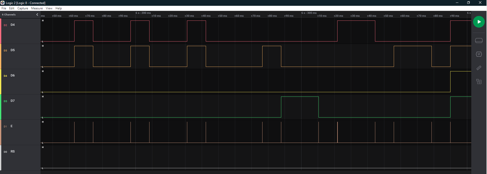

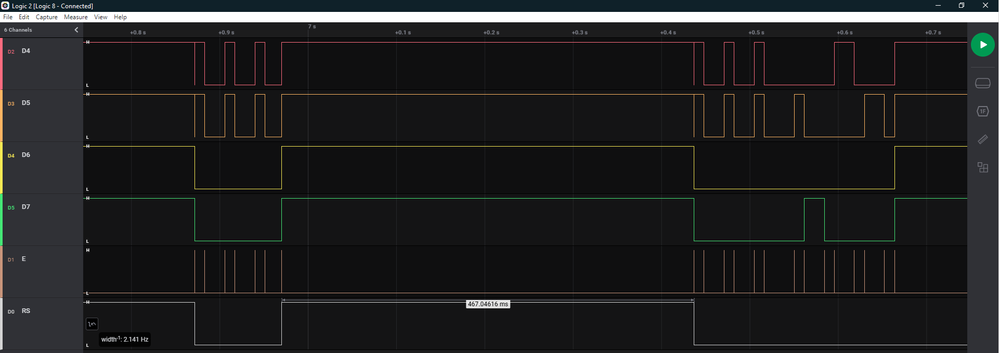

I am using the STM32F411CE to interface with a 16x2 LCD. I wrote a program to initialize the LCD but it hasn't been working. When I attached my logic analyzer to the pins I discovered some odd behavior that I cannot figure out. The program starts to work as expected but then all my data pins go high and enable is triggered. Then all the data pins stay high for around 500ms and then the program runs as expected after that. The odd part is when I place a breakpoint on my Initialization function and then press continue, the program runs without that bug. Below I have my code and pictures of my logic analyzer results.

This is the expected result I get when in debug mode.
This is the result of running the code not in debug mode.
1 REPLY 1
It looks like a chip reset. The part after the 500ms delay is identical to the "expected result".
