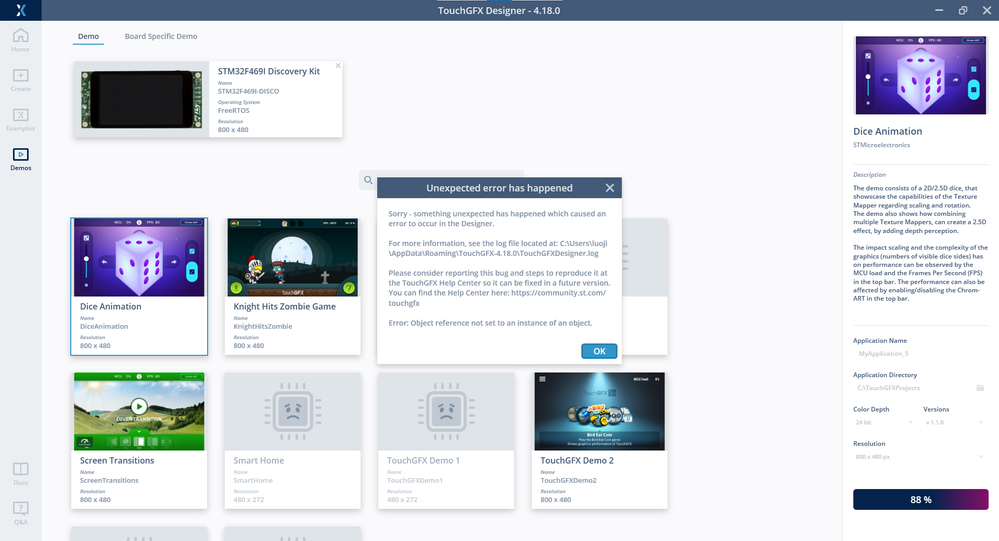

I created an simulator project, but I can’t run it.
The log is as follows:

I tried demos and examples and got the same error.
'MySQL' is not an internal or external command, nor is it an executable program or batch file.
I don't know how to solve it, can anyone help me?:loudly_crying_face:

JLuo.3
0693W00000GXXhhQAH.pngAn exception occurred when I opened the demo.

JLuo.3
I solved this problem myself.
The reason is that mysql is installed on my computer, and everything is normal after uninstalling.
