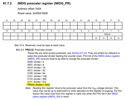

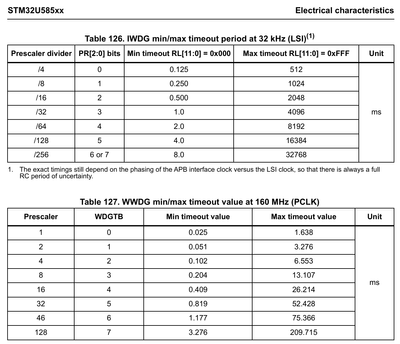

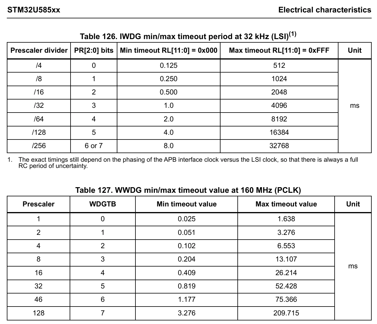

The datasheet shows calculations for min/max timeouts under various conditions.
Note that there's a typo here at least. The Prescaler "46" should be "64".
> LSI clock is 24KHz as I not enable the /128 Prescaler before IWDG.
Note that LSI is 32 kHz, not 24 kHz.
Reference manual suggests the prescaler can be 1024. I'd trust the RM over the DS.
> what is shown in ST example test
Your math seems fine. What test are you referring to? Link it.
==> Ok so I have the same value than the datasheet so my IWDG should be well configured. That solve problem 2.

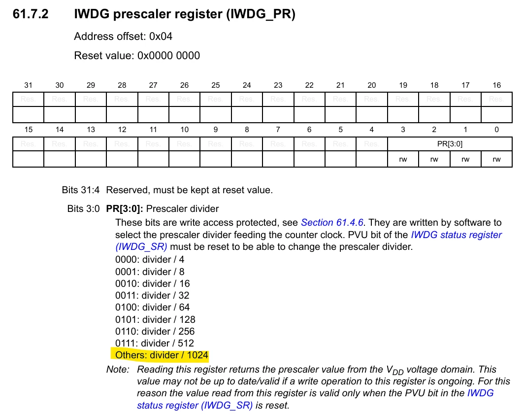

==> This is the prescaler of IWDG that can go up to 1024, the one for WWDG is maximum to 128 (but we can try to reduce PCLK1 but it is not what I want).
