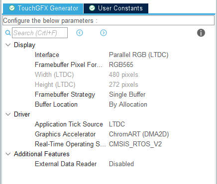

I'm working with a system built around the STM32F767 which has 512kB of internal RAM, and 2MB internal Flash. There is no external RAM or Flash, so the entire application has to live within those resources. We are using RBG565 format with a 480x272 LTDC, and a single framebuffer of 255kB. Since both all the code and all the graphic images must fit into the 2M Flash, we must be quite careful to ensure that we remain within these limits. In general, a full-screen image will require app. 255kB of Flash. We're using TouchGFX Designer 4.17.0, STM32CubeIDE 1.7.0, and TouchGFX Generator 4.17.0.
In the STM32CubeMX editor, a single buffer scheme is selected:

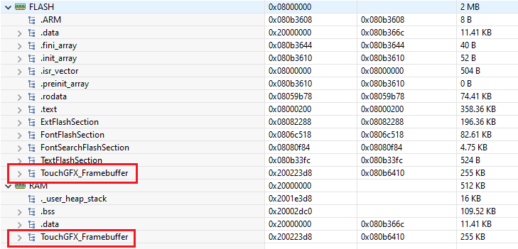

When the project is built without adding a "TouchGFX_Framebuffer" section to the linker files (xx_RAM.ld and xx_Flash.ld), the result is that the buffer is allocated in both RAM and Internal Flash:
Adding a "TouchGFX_Framebuffer" section to the linker files seems to have no effect at all:

The framebuffer is still allocated in both places. I first thought that the entry was simply being ignored, but when I added the tags _tgfxbuf_start and _tgfxbuf_end, they appeared in the .map file:
0x0000000020061fd8 0x0 load address 0x00000000080f6010
0x0000000020061fd8 . = ALIGN (0x4)
0x0000000020061fd8 _tgfxbuf_start = .
*(TouchGFX_Framebuffer TouchGFX_Framebuffer.*)
*(.gnu.linkonce.r.*)
0x0000000020061fd8 _tgfxbuf_end = .
so it's clear that the linker file entry was parsed.

‎2022-02-28 9:50 PM
You buffer falls in "initialized variables" category and during startup firmware copies it (default value) from flash to ram. Make it "uninitialized variable"​.

Thanks very much for the suggestion. I wasn't quite sure how to do so, but you're reply got me searching and I found this link:
https://mcuoneclipse.com/2014/04/19/gnu-linker-can-you-not-initialize-my-variable/
from which I was able to determine that the following syntax would solve my problem:
TouchGFX_Framebuffer (NOLOAD) :
. = ALIGN(0x4);
_tgfxbuf_end = .;
} >RAM
The NOLOAD statement is the key. This may not be the only or the best solution, but it works.
I'm indebted to you for helping me solve an issue that has taken up a good deal of my time. And, in the process, we've gained back about 12.5% of our available Flash.
