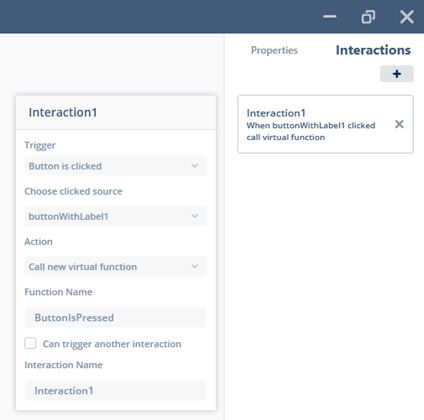

Is there a way to force state for "Button with Label" so that it can behave like "toggle" switch?

There is several ways to achieve what you want to do.
If you really want to use a LabelButton, you can do that easily using a Boolean variable and the "setBitmaps" method :
- In TouchGFXDesigner, create an interaction for your button, which calls a virtual function every time the button is pressed.
- Override this virtual method in Screen1View.hpp.
void ButtonIsPressed() override;
- Create a Boolean variable in Screen1View.hpp.
bool toggle = false;
- In Screen1View.cpp, declare your virtual function, and toggle your Boolean variable every time the method is called.
void Screen1View::ButtonIsPressed()
toggle = !toggle;
- Then, depending on the value of your variable, display either the "pressed button" Bitmap or the "released button" one, with the setBitmap(Bitmap,Bitmap) method. Finally, don't forget to call invalidate.
toggle = !toggle;
if(toggle)
buttonWithLabel1.setBitmaps(Bitmap(BITMAP_BLUE_BUTTONS_ROUND_EDGE_SMALL_PRESSED_ID), Bitmap(BITMAP_BLUE_BUTTONS_ROUND_EDGE_SMALL_PRESSED_ID));
else
buttonWithLabel1.setBitmaps(Bitmap(BITMAP_BLUE_BUTTONS_ROUND_EDGE_SMALL_ID),Bitmap(BITMAP_BLUE_BUTTONS_ROUND_EDGE_SMALL_ID));
buttonWithLabel1.invalidate();
In any case, I strongly recommend you to use either a ToggleButton or a FlexButton.
With the FlexButton widget, you can add a Text on it, and you can modify the trigger to "Toggle" In TGFXDesigner.
Hope that this helped you,
/Yoann
