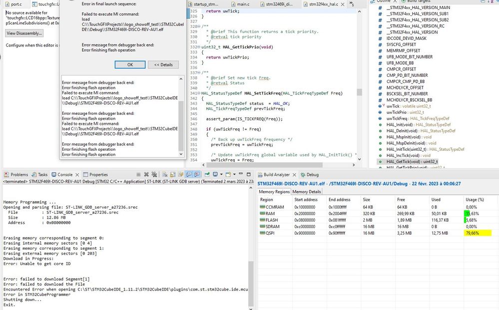

Another example can be seen in the screenshot here:
There is a previous post I did, showing a project which I can fully share, trying to link correctly in the external flash a simple array, with small data like 16B, no problem. If I expand this array from 16B to the real 1.33MB, it fails most of the times. My board is the variant DK32F469I$AU1 - I attached the project so you can try.
I used the latest ST-Link firmware (March 2nd 2023), and both the flash loaders "0x434" from the 2.6 Programmer (replaced in the internal programmer of CubeIDE 1.11.2), but also with the original flash loader.
Programmer data (from the dev board) and the typical error is reported below. Fun fact: the BL version does not appears all the time - comapre with the previous report in this post.

Memory Programming ...
Opening and parsing file: ST-LINK_GDB_server_a02036.srec
  File          : ST-LINK_GDB_server_a02036.srec
  Address       : 0x08000000
Erasing internal memory sectors [0 4]
Erasing memory corresponding to segment 1:
Erasing external memory sectors [0 21]
Download in Progress:
Error: Unable to get core ID
Error: failed to download Segment[1]
Error: failed to download the File
Encountered Error when opening C:\ST\STM32CubeIDE_1.11.2\STM32CubeIDE\plugins\com.st.stm32cube.ide.mcu.externaltools.cubeprogrammer.win32_2.0.500.202209151145\tools\bin\STM32_Programmer_CLI.exe
Error in STM32CubeProgrammer
Shutting down...
Exit.

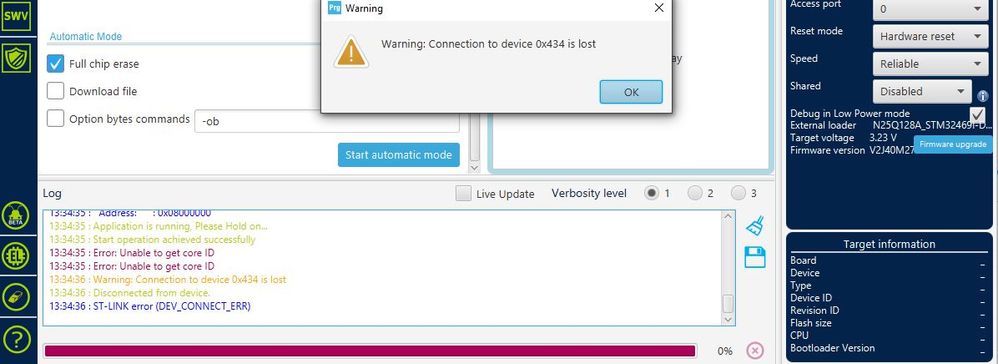

No, is even worse, systematically fails at the second sector [0] to [21] in the example you have, and says that it cannot initialize the memory, with the "newer" loader.
The best would be someone trying on the same board and see what happens. Might be even faulty, mine?

 To finish, I tried with the CubeProgrammer, and the result is the same, it closes the connection
