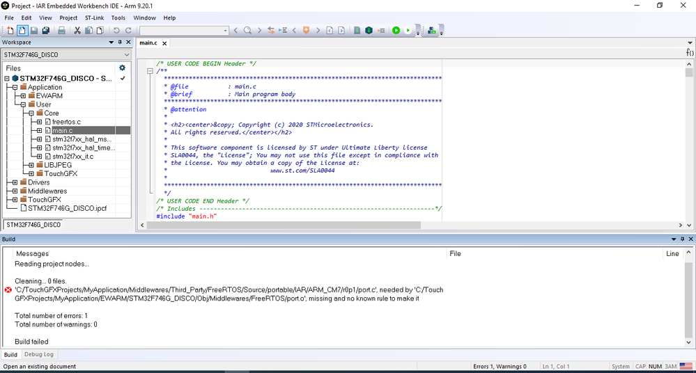

Hi All.
  'C:/TouchGFXProjects/MyApplication_1/Middlewares/Third_Party/FreeRTOS/Source/portable/IAR/ARM_CM4F/port.c', needed by 'C:/TouchGFXProjects/MyApplication_1/EWARM/STM32F429I-EVAL/Obj/Middlewares/FreeRTOS/port.o', missing and no known rule to make it
Subj in question.

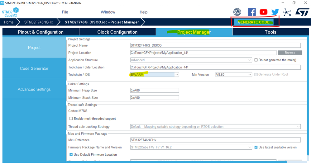

Hello AKovy,
This document does not describe all the steps, it just help you with the "tricky" part with IAR and the .map file. What you need to do is to "Generate code" from STM32CubeMX. This step is mandatory, especially if you change the compiler which is the case because you use IAR here.
So just try to generate code with STM32CubeMX after the creation of your project with TouchGFX Designer.

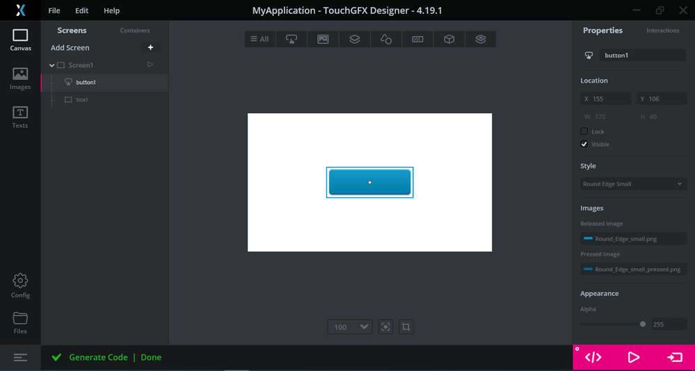

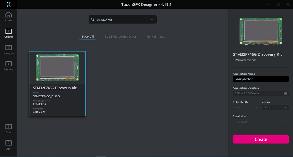

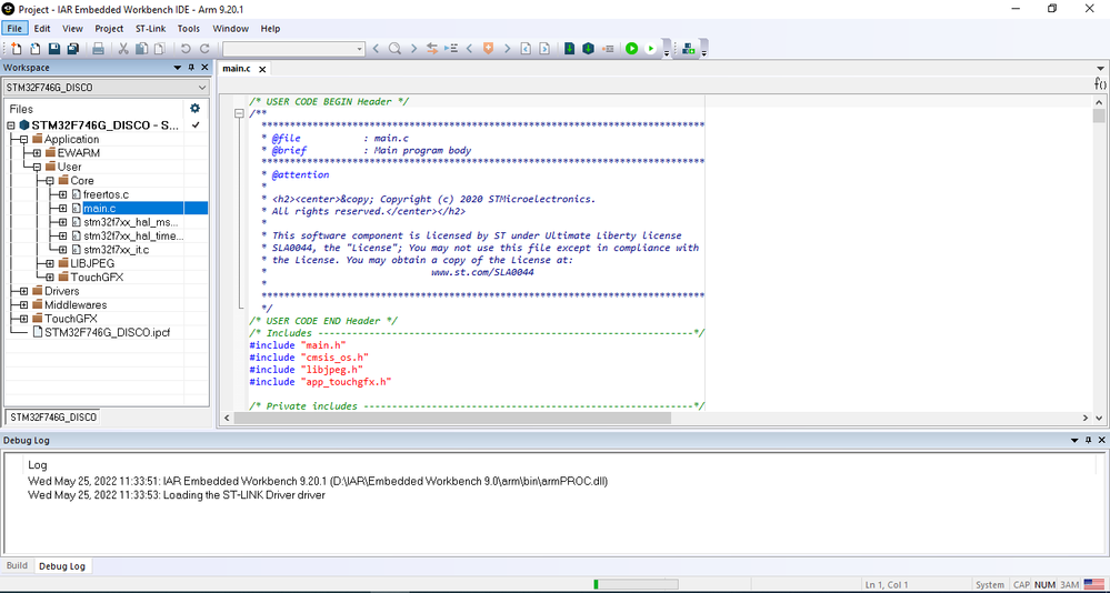

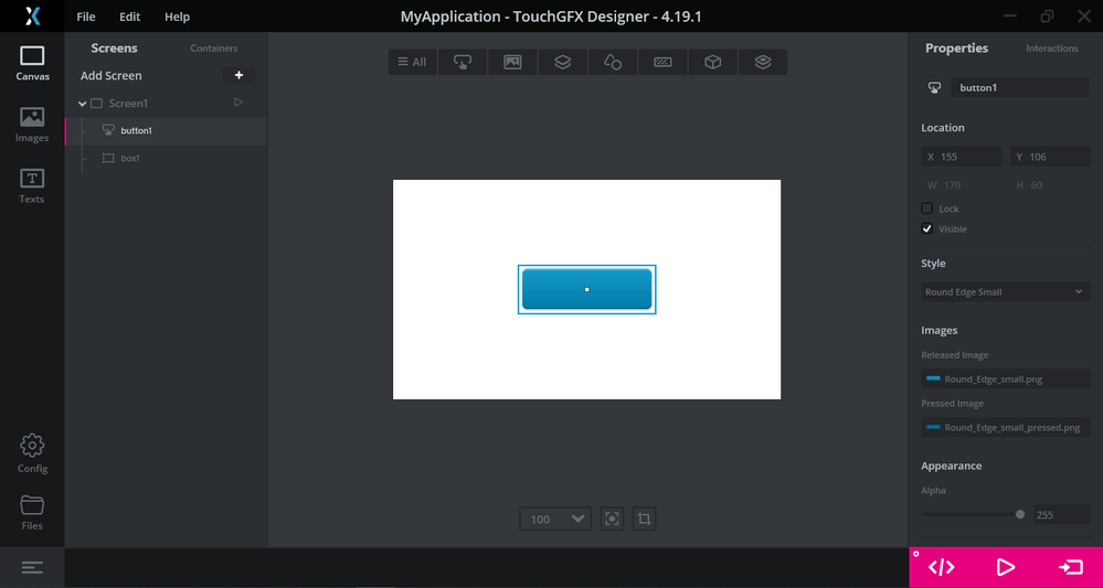

I made screenshots with step by step
01 Before create project.PNG.
0693W00000NqdPVQAZ.png0693W00000NqdPLQAZ.png0693W00000NqdPGQAZ.png0693W00000NqdPBQAZ.png0693W00000NqdP1QAJ.png
Hello Akovy,
Indeed, it seems that you didn't generate code from CubeMX. Can you try with it ?

Hello AKovy,
The "Generate code" from TouchGFX Designer doesn't mean it will compile your project. This will only write some code based on your UI and it will generate code in TouchGFX/generated folder.
/Osman
