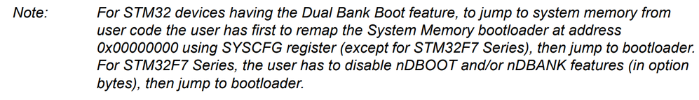

Hi @MAmem.1​,
I can't see any issue. I suggest you to take a look at AN2606 section 4.1 Bootloader activation. It might help.
Best regards,
FBL
