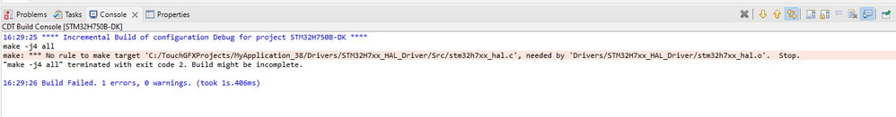

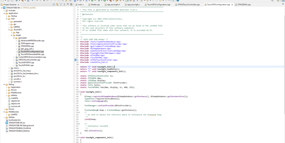

Hi, how can i solve the multiple definition error? what i do is just disable the freertos function and get this error

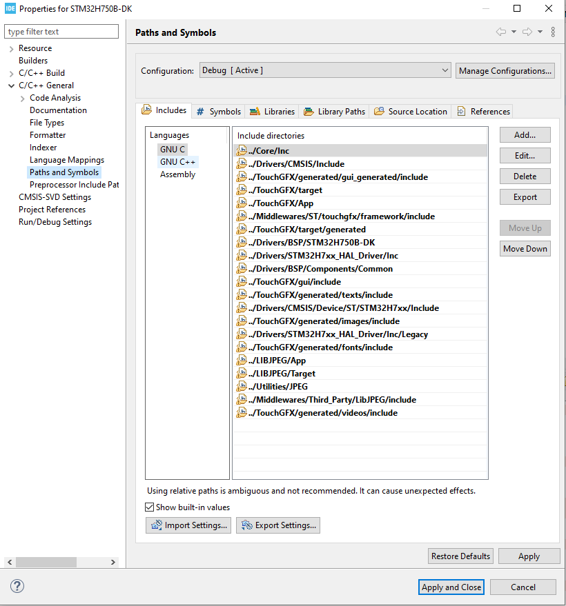

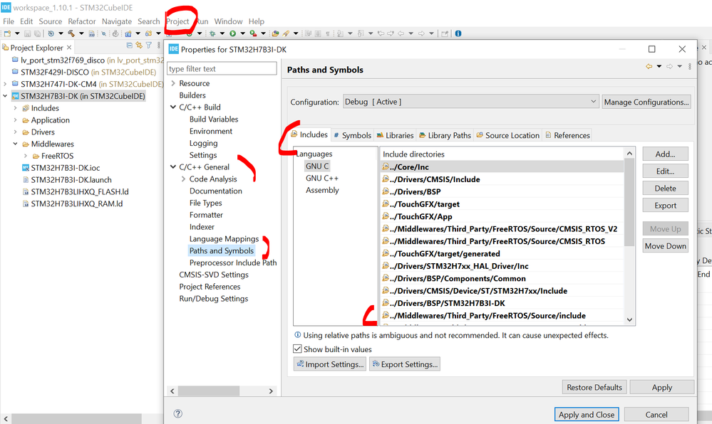

As you can see in the error log the project is looking for files in the Middlewares/Third_Party/FreeRTOS folder. I believe those files are removed from the project folder itself but not in the link path in STM32CubeIDE.
Try to remove them in the tree view on STM32CubeIDE and clean the Path settings as well in the properties settings.
/Romain
the freertos folder in link path also has been remove itself but i don't why it still state the error.

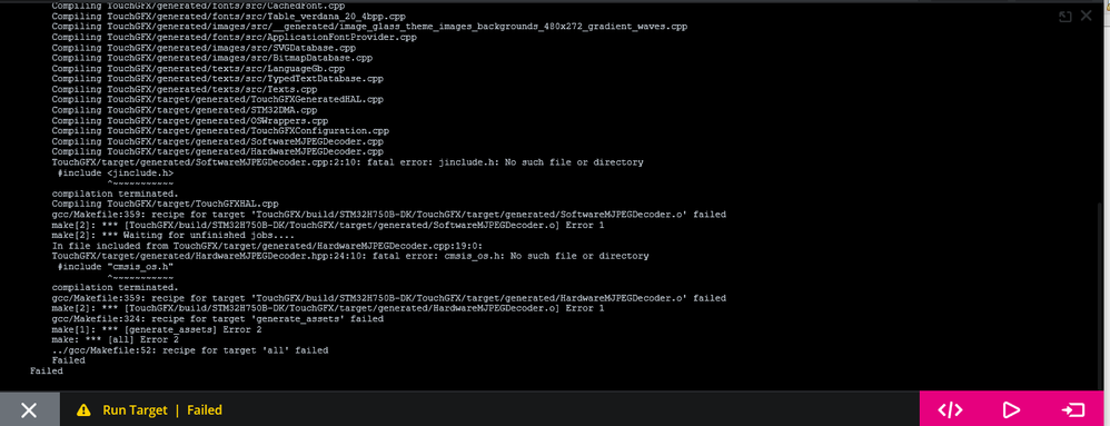

0693W00000Y7oGnQAJ.pngso try to create a new project and disable the freertos. I get these error, could you please advice me how to disable the freertos. what file and folder need to remove ?
im using stm32h750-dk eval board
In the error log you can see that it complains about the " #include ... "
Go to TouchGFXConfiguration.cpp and remove it.
Same for the error in TouchGFXGeneratedHAL.cpp
Have a look at this article in the online documentation.

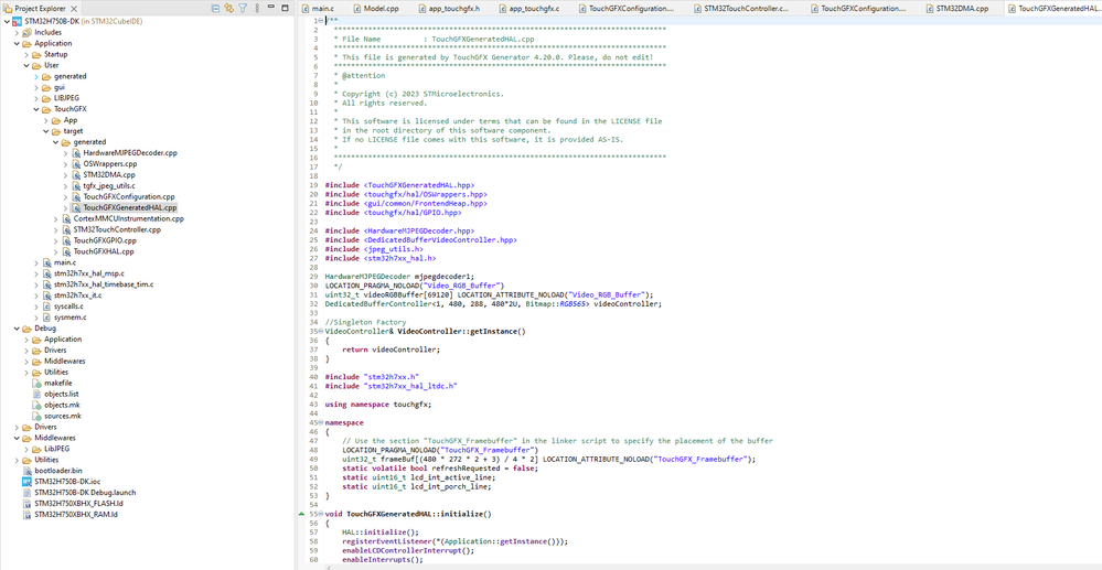

I know it show the error about the #include freertos library. I already go thru these .c file but the #include lib has been remove itself. so i don't know what to do
0693W00000Y7oOrQAJ.pngsame goes to TouchGFXGeneratedHAL.cpp

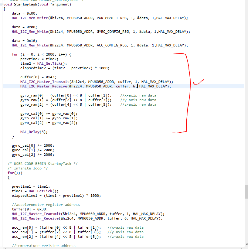

this one I just using the default freertos. Touchgfx using stm32h750-dk. The problem now is the code just can executed up until here. Could you please advise me what wrong wrong with the code? or the structure is wrong . can refer to the project i attached
