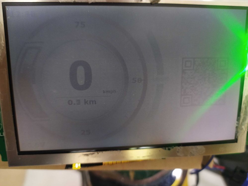

Hello, I am using STM32F746 with FMC SDRAM, QSPI flash, DMA2D. I observed my display is flicking. You can check video using below link.
https://drive.google.com/file/d/1j3uyyHWHlFO-fGW23RI33Iyos6meYaB-/view?usp=sharing
Any suggestions for solving this issue.

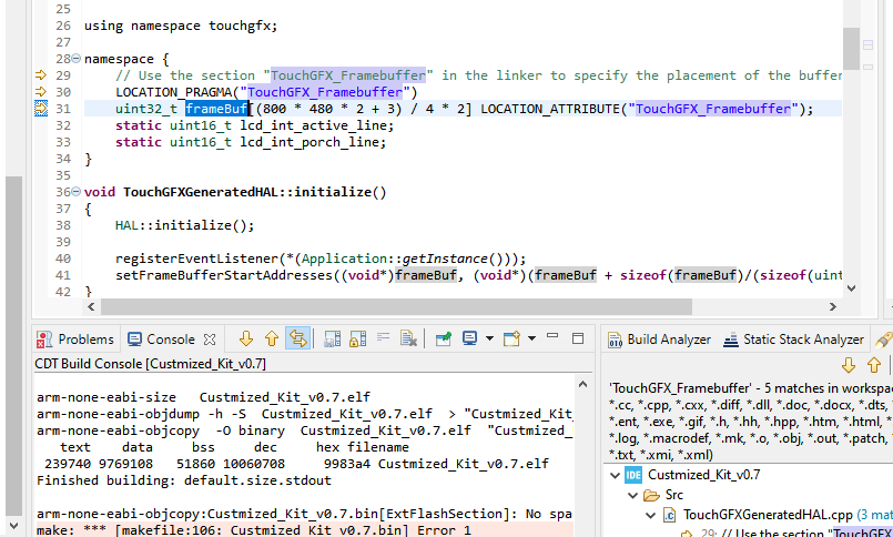

Also frameBuf, It should got to external RAM so i create a session in linker and place it like below:
MEMORY
RAM (xrw) : ORIGIN = 0x20000000, LENGTH = 320K
FLASH (rx) : ORIGIN = 0x8000000, LENGTH = 1024K
EXRAM (rx) : ORIGIN = 0x20000000, LENGTH = 8M
ExtFlashSection :
. = ALIGN(4);
*(TouchGFX_Framebuffer TouchGFX_Framebuffer.*)
. = ALIGN(4);
} >EXRAM
but also this big wouldn't fit in 8MB. Something seems wrong. I am using RGB565.

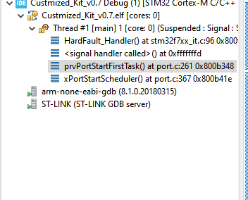

Hello, I am testing the code but now its going for hard fault post prvPortStartFirstTask().
I checked fault register CFSR value, its 0x400.
Thanks
