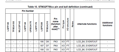

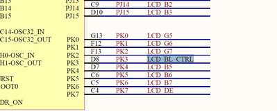

‎2025-04-23 6:24 AM - edited ‎2025-04-23 6:25 AM
Unfortunately you cannot use PWM output with that board as the LCD_BL_CTRL control pin is connected to PK3 that doesn't support any TIM/PWM output:
Maybe you can use PWM in interrupt mode and toggle PK3 pin in it. I don't know if this is efficient.
‎2025-04-23 7:40 AM
Hello!
I assume that using the alpha will not actually cause the backlight to dim? Can you tell me if it would be advisable to use the PWM to cause the backlight to dim? If so, can we use an external display with the backlight connected to a TIM/PWM pin?
Thank you!
‎2025-04-23 7:54 AM
I don't see why you couldn't.
Here it is not possible it seems because that probably wasn't one of our priorities so we connected the backlight controller pin to a standard pin but you could connect it to a PWM pin or maybe even if the display support it to an analog pin (I am not sure about displays capabilities).
Regards,
Software engineer at ST (TouchGFX)
