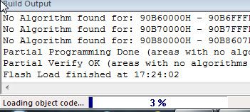

Problem is described here https://community.st.com/s/question/0D53W00000YU9O3SAL/loading-object-code-error
I try to find reason of problem by creating new clear project.

Than I edit project in TouchGFX editor, add one button, generate code, and build it in KEIL.
Than I download it to flash.
Then starting debug I get error, on this stage
this error

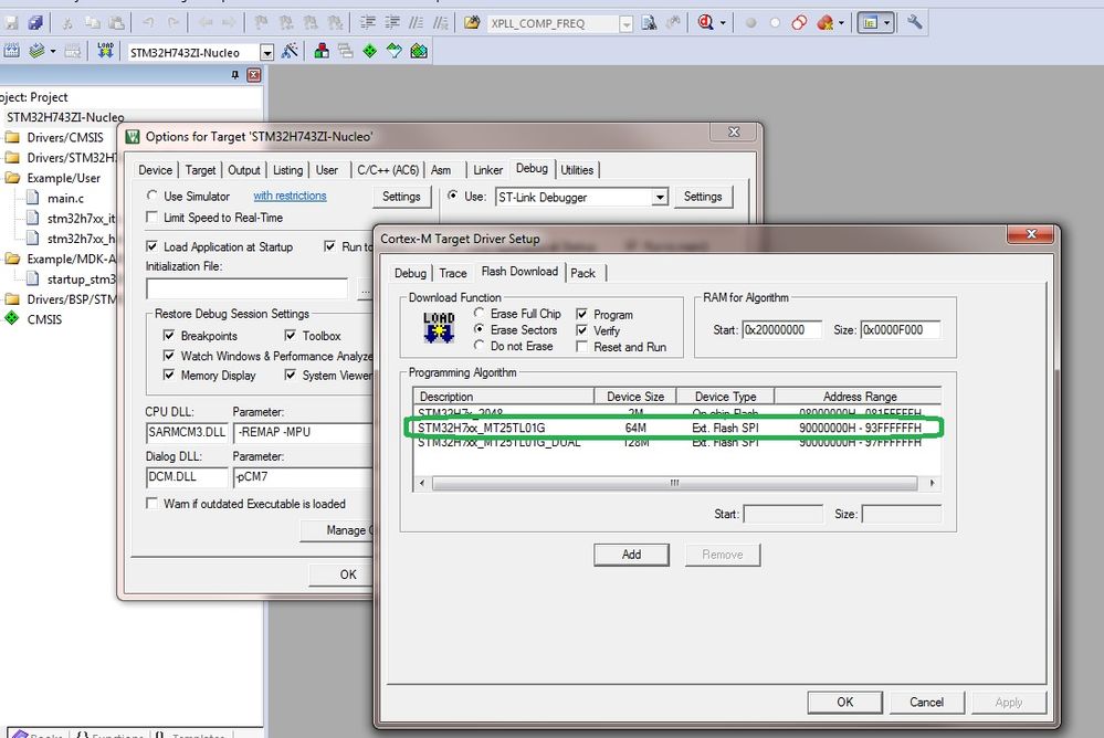

You need to select a Flash Algorithm for the external QSPI Flash

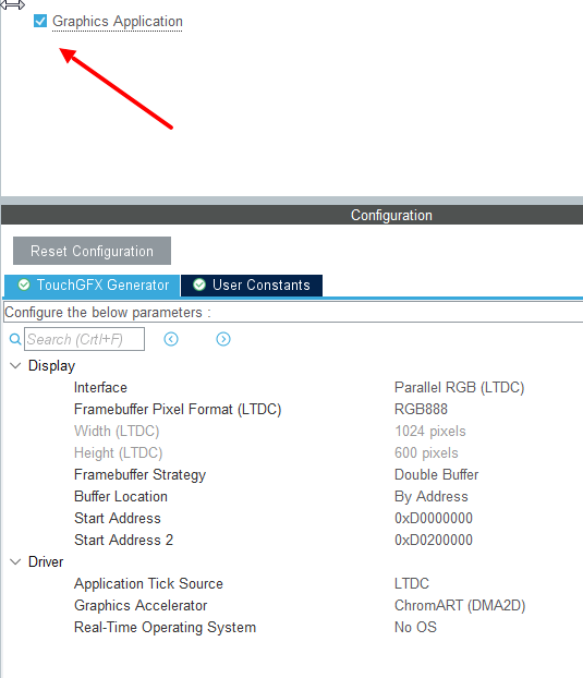

No!
IT is TouchGFX problem.
If I set TouchGX off in CUbeMX - problem disappeared.
‎2021-02-13 9:29 AM
Sorry , when you turn it off, sections ExtFlashSection... is empty = problem disappeared.

I havent downloaded you project (not really allowed to, shady link), could you give more info on how you configured TouchGFX in your project ? If you look at the application template available in TouchGFX Designer for the H747-eval, you can see in the folder /projectName/TouchGFX/target files that we have set ourselves. Those are not generated by TouchGFX Generator. There are more steps involved than just setting it in CubeMX.
/Romain
