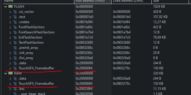

Also I am using internal frame buffer for display but for some reason it is placed in .data section taking space from Flash and RAM memory. Why is that so? 0693W000007EEvWQAW.png
