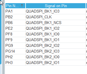

Your second link is for MT25TL01G, but I have MT25QL128
Yor first link - my DFP version is 2.4.0, updater list contains onl 2.5.1. Where you got 2.7.0 version?
Folder STM32H747IDisco_QSPI\QSPI contains SOURCE or .FLM?
My pins
