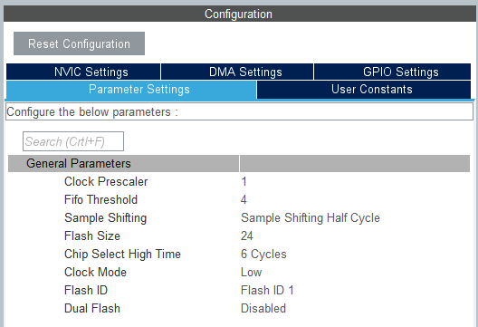

Because I need to utilize more quad SPI flash, I opened up CubeMX by double-clicking the file "f746g-disco-test.ioc" and set the QUADSPI configuration as the following link describes:
https://touchgfx.zendesk.com/hc/en-us/articles/360019884752-Configuring-STM32F746G-DISCO
Then I attempted to run the debugger again and I got the following fatal error on the build:
/Middlewares/ST/TouchGFX/touchgfx/framework/include/platform/hal/simulator/sdl2/HALSDL2.hpp:22:10: fatal error: SDL2/SDL_video.h: No such file or directory
When I checked the simulator directory it was selected to "Exclude resource from build", but I could no longer set it to be excluded from the build.
I set the quad spi flash to the previous settings but this did not resolve the issue.
