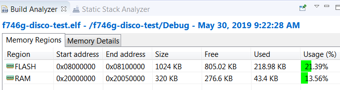

Martin,
I am pretty new with the STM32 in general. I was adding some images into your example with TouchGFX and got the following error:
............ region `FLASH' overflowed by 45788 bytes
collect2.exe: error: ld returned 1 exit status
make: *** [makefile:99: f746g-disco-test.elf] Error 1
"make -j8 all" terminated with exit code 2. Build might be incomplete.
I have created other projects with TouchGFX that used more images in the past so it is likely your example project has something setup up differently that is causing it to use the flash differently. In those previous examples, I used the TouchGFX "run target" option which had no problems. When running your example, the "run target" button is disabled.
Any ideas on how to resolve this would be greatly appreciated.
It looks like the flash is not setup with nearly enough flash space as is available for the STM32F746G-DISCO:
I found the following TouchGFX link discussing configuration of the STM32F746G-DISCO and it said to set this to 24 instead of 1:
https://touchgfx.zendesk.com/hc/en-us/articles/360019884752-Configuring-STM32F746G-DISCO
However, when I tried the configuration (by using the STM32CubeMX perspective in STM32CubeIDE) I got a different compile error altogether. This time, it is failing for not knowing where the TouchGFX simulator files (SDL2/SDL_video.h) . I ran into this error when trying to use STM32CubeIDE in the past and did not find a way to resolve this.
Interestingly, I ran into this same or a similar error when trying to get Atollic TrueSTUDIO to work with TouchGFS.
Any suggestions?

Hi Scott,
The linker script for the project you're working on defines a memory range for various segments (e.g. QUADSPI flash where images are placed by default). You've added enough images to your project to overflow this region by 45788 bytes. If you're adding large full screen images and your bit depth is e.g. 24 this would potentially take up a lot of memory.
Can you tell me something about the nature of your images?
/Martin
Hi @scottSD​,
Oops, didn't notice you'd already replied. The FLASH region is internal flash. QSPI flash will start at 0x90000000 and the buld analyzer does not mention this because it only knows the MCU and the built in flash.
Check the linker script to see how much is allocated for the QSPI region. Here's the gcc linker script i have for an STM32F746G-DISCO project made with CubeIDE. Here, QSPI is 16MB. Check your images and bitdepth and it may make sense.
/* Specify the memory areas */
MEMORY
RAM (xrw)      : ORIGIN = 0x20000000, LENGTH = 320K
FLASH (rx)     : ORIGIN = 0x8000000, LENGTH = 1024K
QUADSPI (r)    : ORIGIN = 0x90000000, LENGTH = 16M
