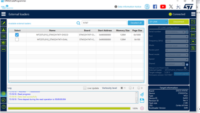

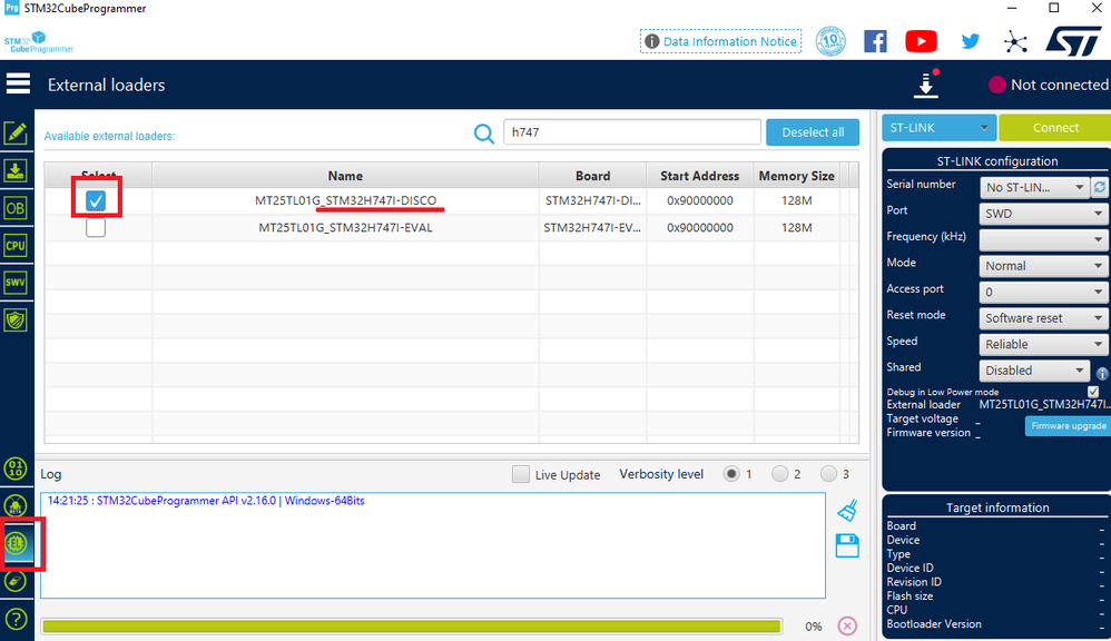

PS: before uploading the hex file related to the CM7, make sure you selected the external flash loader for this board:
slimani
I didn't understand your answer correctly but I opened stmprogrammer and I found this file and I clicked on connect, what is this file for? Is it for you to upload this file and then I upload the project if it explains to you what exactly needs to be done?
This the flashloader used by STM32CubeProgrammer to upload the external Flash (QuadSPI). The quad SPI flash contains the TouchGFX assets: images, texts etc..
Select that Flash loader then upload the two hex files as I mentionned before. Did you see somthing on the screen?
I uploaded the two .hex files from CM7 and CM4 but the screen remains black and does not light up. The screen only lights up when I upload the demo project. I don't understand the cause of this.
