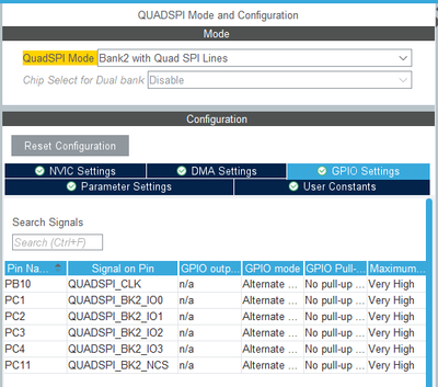

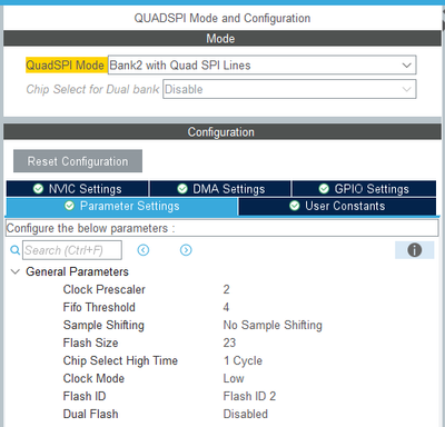

My processor is an STM32L496VGT6 and its connected via quadSPI to an MT25QL128A 16MB external flash memory. I'm running the clock at 80MHz, and my QUADSPI is setup like this (both in my custom loader, and in the application code I'm developing):

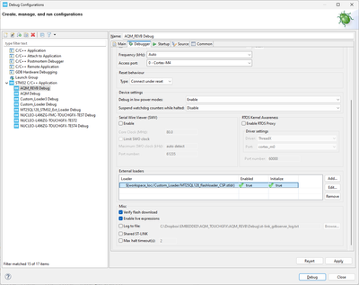

Where my problem begins is when I attempt to use the new external loader I generated in my debug sessions while trying to develop my main application. Here I've gone into the debug sessions, pointed to my generated loader file, and started to debug.
With the external loader enabled as above, the code stops on the first use of:

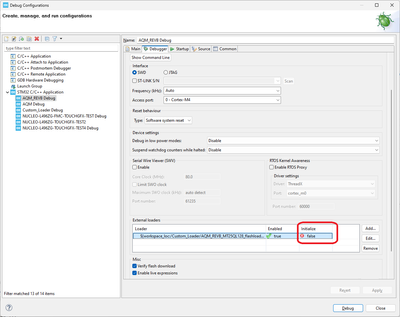

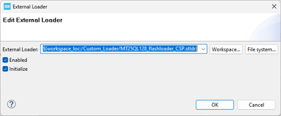

Holy Carp!
My external loader was more or less working all along. I just needed to not have "initialize" checked in the external loader debug settings.
An ST field applications engineer took a look at it and that was all it was. I'll try to post a follow up with a few more details on Monday, but that was pretty much it. Many thanks for those of you who offered advice, and a special thanks to @Tesla DeLorean for trying to help me work through it.
