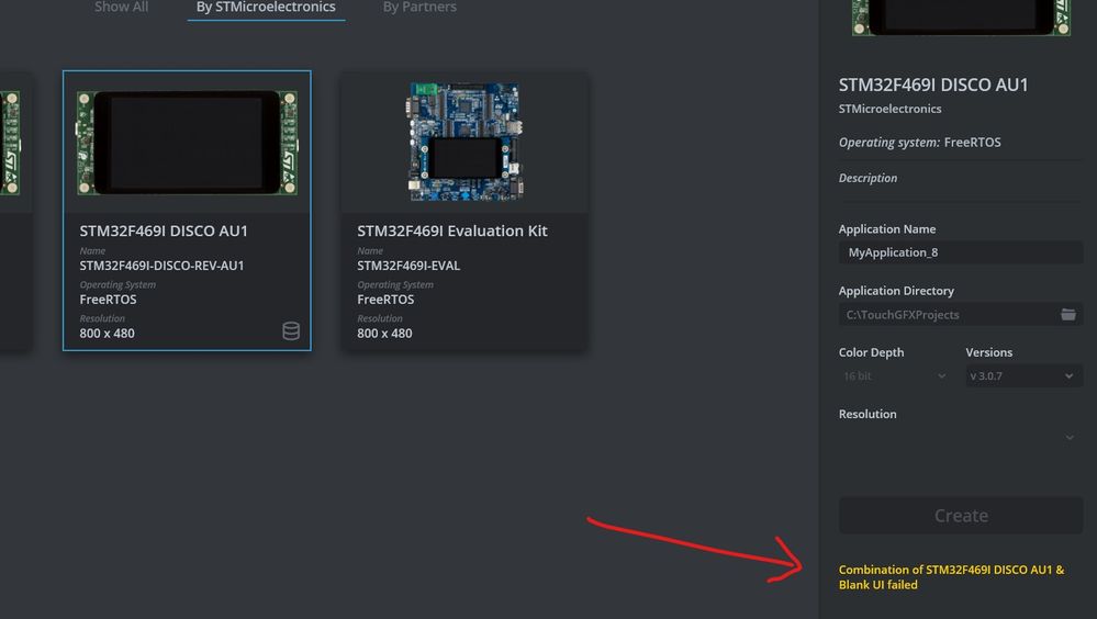

I am trying to create a project in Touchgfx designer 4.24.1 for STM32F469I-DISCO board but I always get "combination of board and Blank UI failed". I also tried with other boards without success. I am using fresh installed windows 10. I also tried to uninstall and install back again Touchgfx. Bellow is my log file from appdata/roaming...

2024-10-28 16:44:51,478 [11] INFO Utils.WebHandling.WebHandler: Downloading stm32-desc-7inch-1.png
2024-10-28 16:44:52,206 [11] ERROR Utils.WebHandling.WebHandler: One or more errors occurred. (Response status code does not indicate success: 404 (Not Found).)

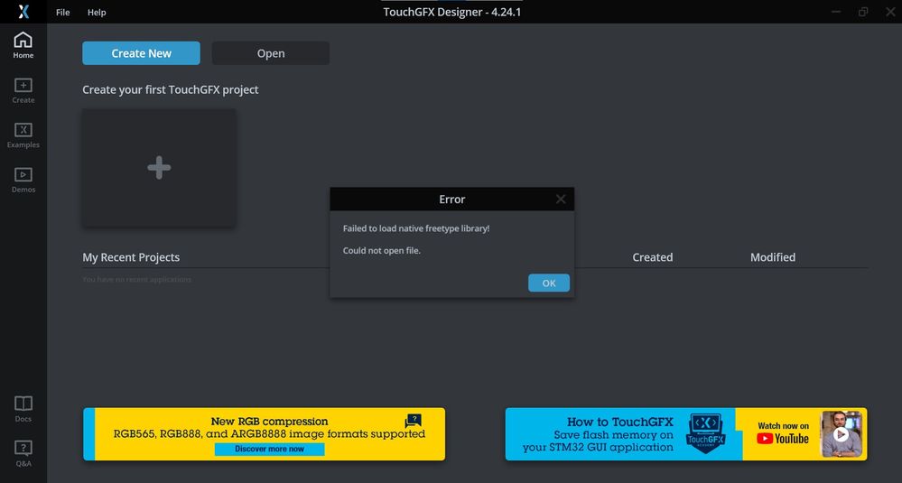

2024-10-28 16:46:46,181 [.NET ThreadPool Worker] ERROR TouchGFXDomainModel.LoadSave.LoadSave: Failed to load native freetype library!
System.IO.FileLoadException: Failed to load native freetype library!

2024-10-28 17:00:19,378 [1] INFO TouchGFXDesigner.Main.MainWindow: Windows version: Microsoft Windows NT 10.0.19045.0
2024-10-28 17:00:19,378 [1] INFO TouchGFXDesigner.Main.MainWindow: Current culture: en-US
2024-10-28 17:00:19,378 [1] INFO TouchGFXDesigner.Main.MainWindow: Current culture time seperator: :
2024-10-28 17:00:19,378 [1] INFO TouchGFXDesigner.Main.MainWindow: Current culture date seperator: /
2024-10-28 17:00:19,418 [1] INFO TouchGFXDesigner.Main.MainWindow: Installed .NET version(s): v4 (Client 4.8.09037 Full 4.8.09037 ) v4.0 (Client 4.0.0.0 )
2024-10-28 17:01:43,117 [11] INFO Utils.WebHandling.WebHandler: Downloading stm32-desc-7inch-1.png
2024-10-28 17:01:43,339 [11] ERROR Utils.WebHandling.WebHandler: One or more errors occurred. (Response status code does not indicate success: 404 (Not Found).)
System.AggregateException: One or more errors occurred. (Response status code does not indicate success: 404 (Not Found).)
---> System.Net.Http.HttpRequestException: Response status code does not indicate success: 404 (Not Found).
at System.Net.Http.HttpResponseMessage.EnsureSuccessStatusCode()
at Utils.WebHandling.FileDownloadUtil.DownloadFile(Uri uri, String filePath, IProgress`1 progress, Action completion, Action`1 bytesReceived, CancellationToken cancellationToken)
--- End of inner exception stack trace ---
at System.Threading.Tasks.Task.ThrowIfExceptional(Boolean includeTaskCanceledExceptions)
at System.Threading.Tasks.Task.Wait(Int32 millisecondsTimeout, CancellationToken cancellationToken)
at System.Threading.Tasks.Task.Wait()
at Utils.WebHandling.WebHandler.DownloadFile(Uri uri, String filePath, IProgress`1 progress, Action completion, Action`1 bytesReceived, CancellationToken cancellationToken)
2024-10-28 17:01:43,339 [11] ERROR TouchGFXPackages.Implementation.FileDownloader: Failed to download: https://cdn.riverdi.com/wp-content/uploads/2022/07/stm32-desc-7inch-1.png
2024-10-28 17:01:47,908 [.NET ThreadPool Worker] DEBUG TouchGFXPackages.Implementation.TouchGFXPackageStream: Filestream opened on C:\TouchGFX\4.24.1\app\packages\Simulator-2.0.0.tpa
2024-10-28 17:01:47,968 [.NET ThreadPool Worker] DEBUG TouchGFXPackages.Implementation.TouchGFXPackageStream: Filestream opened on C:\TouchGFX\4.24.1\app\packages\BlankUI-2.0.0.tpa
2024-10-28 17:01:47,969 [.NET ThreadPool Worker] DEBUG TouchGFXPackages.Implementation.TouchGFXPackageStream: Filestream opened on C:\TouchGFX\4.24.1\app\packages\BlankUI-2.0.0.tpa
2024-10-28 17:03:05,195 [.NET ThreadPool Worker] INFO Utils.WebHandling.WebHandler: Downloading STM32C071RB_NUCLEO-3.0.1.tpa
2024-10-28 17:03:06,645 [.NET ThreadPool Worker] DEBUG TouchGFXPackages.Implementation.TouchGFXPackageStream: Filestream opened on C:\Users\meme\AppData\Roaming\TouchGFX-4.24.1\Downloads\STM32C071RB_NUCLEO\3.0.1\STM32C071RB_NUCLEO-3.0.1.tpa
2024-10-28 17:03:06,659 [.NET ThreadPool Worker] DEBUG TouchGFXPackages.Implementation.TouchGFXPackageStream: Filestream opened on C:\TouchGFX\4.24.1\app\packages\BlankUI-2.0.0.tpa
B

‎2024-10-29 03:47 AM
Is that an error thrown by the TouchGFX designer?
What "Riverdi" is doing here? Are you sure you are starting with STM32F469I-DISCO board not with a Riverdi board?
2024-10-28 16:59:07,775 [11] ERROR TouchGFXPackages.Implementation.FileDownloader: Failed to download: https://cdn.riverdi.com/wp-content/uploads/2022/07/stm32-desc-7inch-1.png
PS:
1 - This is NOT an online support (https://ols.st.com) but a collaborative space.
2 - Please be polite in your reply. Otherwise, it will be reported as inappropriate and you will be permanently blacklisted from my help.
‎2024-10-29 09:02 AM - edited ‎2024-10-29 09:15 AM
Yes this is an error thrown by Touchgfx Designer.
I definitely tried to create a project with STM32F469I-DISCO board, without success. After that I also tried to create only simulator project with no board but also failed. Then I also tried with other boards but I don't remember trying Riverdi.

‎2024-10-31 01:58 AM
‎2024-10-31 03:34 AM
Some more info (maybe it will help) @GaetanGodart @mÆŽALLEm
When I press Create button it starts creating the project but fails at about 90% then Touchgfx crashes.
After that I tried to open the "partialy created" project but I got an error: Failed to load native Freetype library! could not open file.
‎2024-10-31 03:48 AM
Found the solution. I was missing VC++ similar to this post: https://community.st.com/t5/stm32-mcus-touchgfx-and-gui/touchgfx-crashes-on-project-creation/td-p/578159
