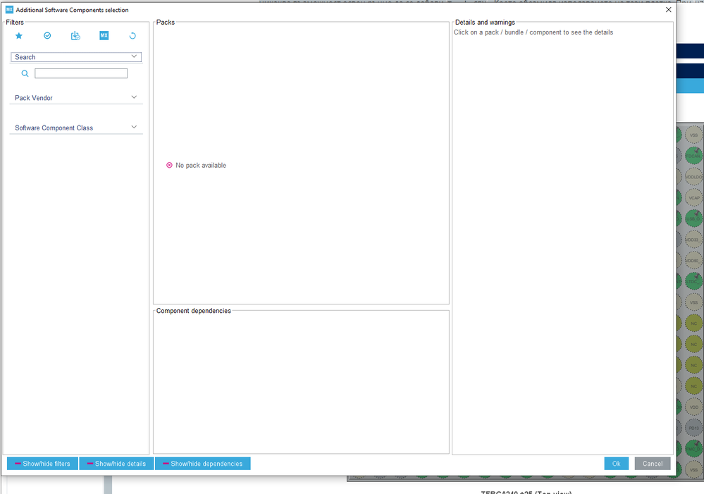

[bug] STM32CubeMX 5.6.1/ H745-Disco/Additional Software - No Pack Available
  • May 29, 2020
  • 980 views
When starting project STM32CubeMX with H745-Disco in the section Additional Software -Packs a message No Pack Available appears. There is no option other than to manually add Touch GFX. Which makes the use of this board meaningless. With H750-Disco This problem is absent. Please help me how to include Touch GFX in the STM32CubeMX project with H745-Disco. My idea with the purchase of this board to study the use of ТouchGFX and the use of this processor for future projects, but a bad surprise :(
0693W000001pgRZQAY.pngPS: and H747 has the same problem

​Hello @Panchev68​
Well , it's not an issue but for the Dual core, it still not supported, it will be in a next release.
Thanks For your feedback,
Best Regards,

After 2 months of waiting, the new release of the STM32Cube again does not support the H745. Apparently this board goes to waste.:pouting_face:
