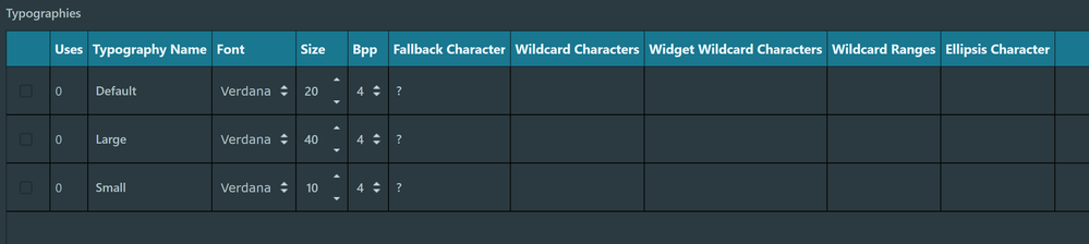

In the Designer, you will find the Typography tab as below :
You can see that the typo is 4bpp. But if you have a 1 bpp display configuration for instance, you will have a conflict. In this case, you can lower the bpp for the typos.
/Alexandre

Hello and thank you for quick reply.
Originally I had set a 1bpp color format, also in typographies. The simulator project builds an runs ok.
After having noticed that VSync signal leads to HardFault, i tried making whole project from scratch (on Nucleo). It is a simple view with black background and a white circle on top, no texts etc.. Also no LCD transfer is made, only empty dummy functions that return immediately. When I started Nucleo project, I tried different formats: 1bpp, 4bpp and RGB565 (this is the attached project). It still craches... But when changed to STM32F746 platform, it runs ok - no crash.
