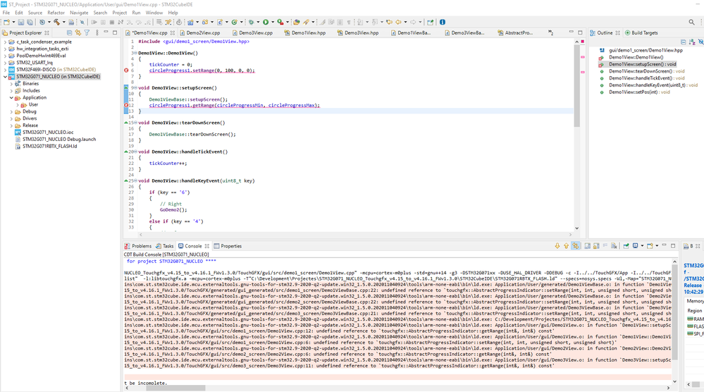

Q8
Ok, thanks it is working now, but now I have another problem. So, when flashing from TGFX Designer it Flash ok with no compiling error. But when I try to laucnh from CubeIDE the following errors for setRange and getRange apear...
c:\development\st\stm32cubeide_1.2.0\stm32cubeide\plugins\com.st.stm32cube.ide.mcu.externaltools.gnu-tools-for-stm32.9-2020-q2-update.win32_1.5.0.202011040924\tools\arm-none-eabi\bin\ld.exe: Application/User/generated/Demo1ViewBase.o: in function `Demo1ViewBase::Demo1ViewBase()':
C:/Development/Projectes/STM32G071_NUCLEO_Touchgfx_v4.15_to_v4.16.0/TouchGFX/generated/gui_generated/src/demo1_screen/Demo1ViewBase.cpp:22: undefined reference to `touchgfx::AbstractProgressIndicator::setRange(int, int, unsigned short, unsigned short)'
The error messages indicate that you are using the FW package 1.3.0, is it the case or are you using the v1.4.1 ? If you are using the latest one maybe try to regenerate code from CubeMX, then regenerate code from TouchGFX Designer. Then "clean" the CubeIDE project (I think you have to right click on the name of your project in the tree view on the left) and finally press "build".

Q8
Yes, I am using 1.4.1. Tried to regenerate, cleand and build, but same errors showed up. This was trying to update a project from TGFX 4.15 to 4.16.1.
C:/Development/Projectes/STM32G071_NUCLEO_Touchgfx_v4.15_to_v4.16.1_FWv1.4.1_Uart_notworkcubeide/TouchGFX/generated/gui_generated/src/demo1_screen/Demo1ViewBase.cpp:22: undefined reference to `touchgfx::AbstractProgressIndicator::setRange(int, int, unsigned short, unsigned short)'
