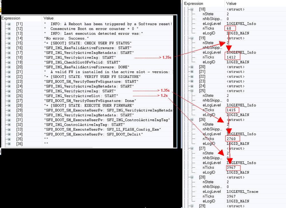

I have added an image in attachment showing where the time is mainly spend with the current timings (1 tick = 1ms ).
I don't think I see much of the ECDSA time you are refering to. I only see significant time spend in the 2 functions i just mentioned, one of them being an SHA256 calculation over the firmware (VerifyActiveImage) and one checking the region after the firmware for no spurious code (VerifyActiveSlot). This is if I understand what these functions are doing correctly.

Ok so I looked with the scope and some prints
SFU_IMG_VerifyActiveImgMetadata: Start
[383ms]
SFU_IMG_VerifyActiveImg: Start
[4343ms]
SFU_IMG_HasValidActiveFirmware: Done
[383ms]
[387ms]
[388ms]
SFU_IMG_ControlActiveImgTag: Start
Seems like ticks (interrupts?) are indeed disabled for long periods during these calculations
And I will get nowhere near 500ms using the SBSFU mechanisms.
