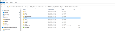

‎2023-06-19 3:18 AM
Hello Jocelyn,
Thanks for your replay,
I have checked repo of stm32u5 "en.stm32cubeu5-v1-2-0"
it has an SBSFU example so can I use this example?
Below we mention my project requirement
1. Firmware should upgrade through URAT port(Through TERATERM or any serial loader) and support secure boot features like sign image upgrade.
so can you give guidance on which is better SBSFU or TFM for the STM32U585ZIT6 controller?
‎2023-06-23 6:56 AM
Hello @HirenThumar2702,
The SBSFU project will fulfil your requirement.
The TFM example provides also a secure boot (based on the same MCUboot as SBSFU example) but instead of providing a simple secure application as example, provides the TFM porting on STM32U5. It provides secure services such as crypto and secure storage.
Best regards
Jocelyn
