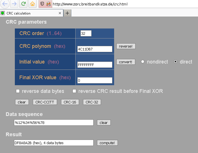

The standard STM32 implementation is 32-bit at a time, MSB first, left-shifting. Awkward for sure..
0x00000000 into 0xFFFFFFFF should yield 0xC704DD7B
0x66666666 into 0xFFFFFFFF should yield 0x47EC5BD8
waclawek.jan
(gdb) set CRC->CR=1
(gdb) p /x *CRC
$7 = {DR = 0xffffffff, IDR = 0x0, RESERVED0 = 0x0, RESERVED1 = 0x0, CR = 0x0,
  RESERVED2 = 0x0, INIT = 0xffffffff, POL = 0x4c11db7}
(gdb) set CRC->DR=0x12345678
(gdb) p /x *CRC
$8 = {DR = 0xdf8a8a2b, IDR = 0x0, RESERVED0 = 0x0, RESERVED1 = 0x0, CR = 0x0,
(gdb)

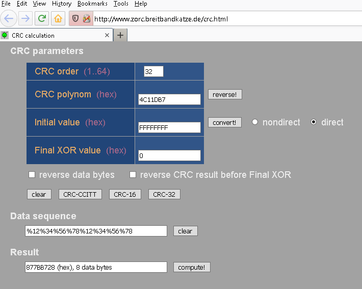

I implemented the algorithm you shared, and I get results which match those that your and Jan shared for all the simple cases that you showed. But, they are not what I get out of the stm32f429 that I’m running. For example:
* For 0x12345678 I see 0x877bb728 instead of df8a8a2b
* For 0x0 I see 0x6904bb59 from the CRC unit
Tomorrow, I’ll write code to run it JIC there is something odd about how I’m running it from the Keil debugger – (from the peripherals -> System Viewer -> CRC I check the CR box to reset DR to f-s, enter a value into the DR input and hit return) but I’m fairly certain I tried from compiled code before.
There is something odd about how Keil debugger runs it - apparently, it writes twice:
0693W000008x0TSQAY.pngAlso, when writing your program, be aware of this gotcha.
Yes – that is what I’m seeing. Thanks (I guess I hadn’t checked with code – at least not since having the right expectation).
