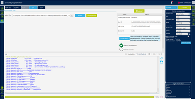

I then tried to do the entire process using the STM32CubeProgrammer on another board.
I'we followed the video: STM32H5:Product state
- I flashed my application (a simple blinking LED) with IAR
- I changed the product state from "Open" to "Provisioning"
But no luck. Once the Provisioning state is set, I can't provide the *.obk file using the PROV dropdown.
Product state is 0x17 as correctly expected:
So both behaviours are equals using directly HALs drivers or STM32CubeProgrammer.

Thank you @Jocelyn RICARD,
connecting NRST to pin 15 of STLink V2 all works fine!
