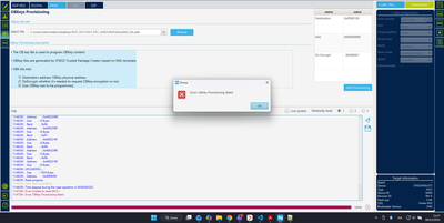

I then tried to do the entire process using the STM32CubeProgrammer on another board.
I'we followed the video: STM32H5:Product state
- I flashed my application (a simple blinking LED) with IAR
- I changed the product state from "Open" to "Provisioning"
But no luck. Once the Provisioning state is set, I can't provide the *.obk file using the PROV dropdown.
Product state is 0x17 as correctly expected:
So both behaviours are equals using directly HALs drivers or STM32CubeProgrammer.
Can anyone please help me figure out what I'm doing wrong?
Thanks in advance for your help.

Jocelyn RICARD
Hello @MattiaB ,
please connect in hotplug mode. You will be able to provision the board.
Then please check you can do a regression in this state before going further.
This will validate that the DA obk you provided is correct.

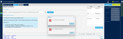

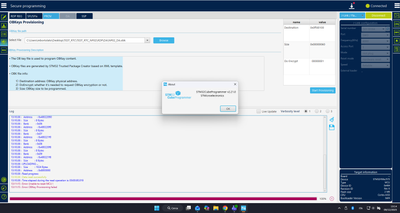

Hi @Jocelyn RICARD,
Also in hotplug mode I'm not able to provide the OBKey:
The STM32CubeProgrammer is the last downloadable:
Jocelyn RICARD
Hello @MattiaB,
please try using a STlink probe instead of J-Link probe.
It is possible the Segger does not properly support the provisioning through the programmer.
Other solution could be to use the PC Segger tools using up to date driver.
Best regards
Jocelyn

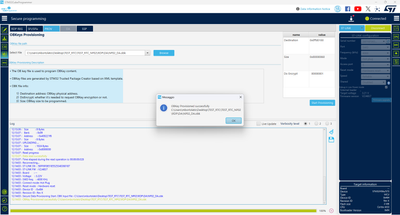

Good morning @Jocelyn RICARD,
Thank you — provisioning is now working.

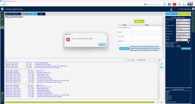

Thank you for the response @Jocelyn RICARD,
I powered the board, navigated to the "shield" icon, and pressed Discover.
Unfortunately, the discovery process failed.
When connecting to the target, I can see that it has clearly remained in the provisioning state.
I am not sure why the discovery fails. Do you have any idea what might be causing this?
Thank you again for your patience and the support you are providing. I look forward to your feedback.
Jocelyn RICARD
Hello @MattiaB ,
Can you check that you have connected the reset signal to the STLink Probe?
The Debug Authentication requires the control of this reset signal
Best regards
Jocelyn

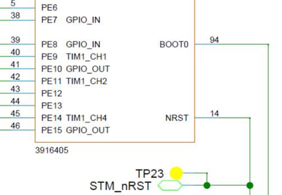

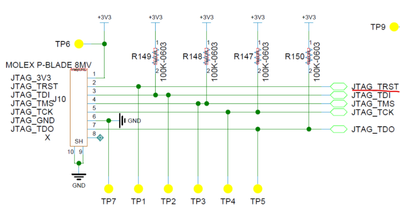

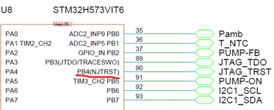

Hi @Jocelyn RICARD,
if you mean the NJTRST it's connected to the STMLink probe as follows:
If you mean NRST, it is NOT connected to the STLink probe:
Let me know if it's correct.
Jocelyn RICARD
Hello @MattiaB ,
I confirm that you need to control the NRST pin to make Debug Authentication work
Best regards
Jocelyn
