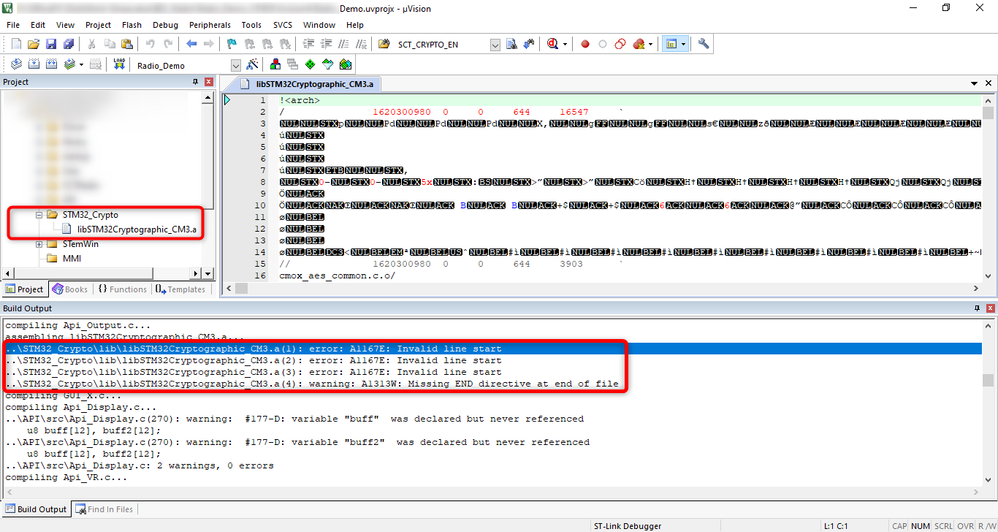

We had a project built using ST Crypto V2.0.6 (M3_CryptoHW_2_0_6.lib) library in Keil IDE. Now we replaced the ST Crypto library by V4.0.1 (libSTM32Cryptographic_CM3.a)
We are seeing the following errors
..\STM32_Crypto\lib\libSTM32Cryptographic_CM3.a(1): error: A1167E: Invalid line start
..\STM32_Crypto\lib\libSTM32Cryptographic_CM3.a(2): error: A1167E: Invalid line start
..\STM32_Crypto\lib\libSTM32Cryptographic_CM3.a(3): error: A1167E: Invalid line start
Attached is the screen shot of the project.
Let us know the procedure to update the library and if any workarounds are present.

Can you try compiling one example provided for cortex M3 in
STM32CubeExpansion_Crypto_V4.0.1\Projects\NUCLEO-L152RE\
On my side, with Keil 5.33 this is compiling without issue.

You're trying to assemble a library. Read the Keil documentation.

Besides to proposals from @alister​ and @Jocelyn RICARD​ , I suggest you to refer to the wiki article Migration from previous Cryptographic Library version. I hope you will find required help there.
