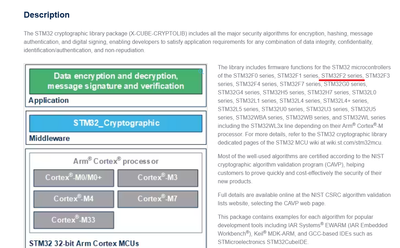

I want to implement encryption in STM32F205RG. I came to know that there is no Hardware support, so is there any STM32 crypto library for STM32F205RG ? I want to implement AES encryption and decryption function.

mƎALLEm
X-CUBE-CRYPTOLIB
It supports STM32F2 devices.
Hope that helps.
