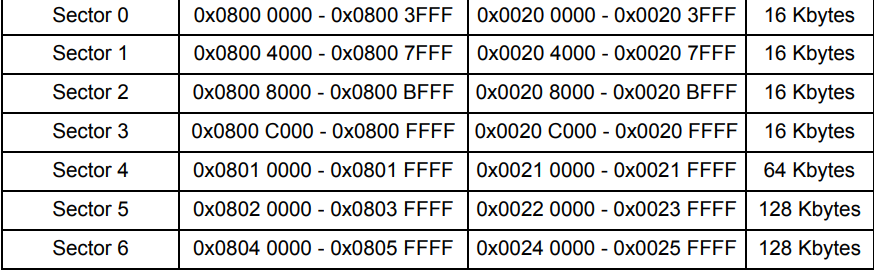

I'm using a STM32F722RE and in my current application, I used sector 2 and 3 of the flash as a virtual EEPROM. The memory of the controller looks like this:
So sector 4 should be enough for the SBSFU and I would like to set my application to sector 5 and the download area to sector 6. Now, when I change everything in the linkerscript, the controller goes somewhere unexpected and I lose the debug connection,

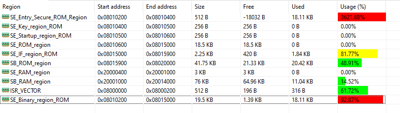

From my testing, always when I choose another start address for the SBSFU than 0x8000000, the update process over tera term fails and the SBSFU firmware gets bricked. The thing is, the SBSFU boots correctly before I flash the first time the application.
I also tried to split as follows, but this leads to the same error:

I need sector 2 and 3 for my application, sector 4 is 64kbyte at once, and I need at least two pages for the virtual eeprom emulation. I don't see, why it should not be possible to start at another sector or at least, only the vector table at 0x08000000 and the rest goes to sector 4?

I also have trouble here, when I set the vector table to 0x08000000 and the rest of the SBSFU to 0x08010000. I can start a firmware update over UART, but the SBSFU crashed after the start and is then permanently destroyed until I erase and reprogram it. Might there be a problem with the MPU set in the example projects?

Well, I defined SECBOOT_DISABLE_SECURITY_IPS to deactivate all the safety features, still no success. I really don't know what else I could try.
STsch.1
I tested now the STM32L152RE example, there I was able to start the SBSFU at 0x08010000, when the vector table is at 0x08000000 (also tested without MPU). Now, I think there is some other settings that needs to be adjusted for each uC type, but I really don't find anything about that.
STsch.1
Ok, i could solve it, it works, when I put the application to 0x08040000. I really don't see, why it does not work for 0x08020000, there is nothing else there, that should make complications.
I'm not sure whether you are still on F7 or it's the L1 now, but I'm glad you managed to make it work.
J
I am still on the F722, but I don't get it why it does not work when the app is at 0x08020000, there is nothing in this flash region from the SBSFU and I also tested it on different hardwares to ensure, the flash is ok. Also MPU is disabled. I need to further investigate this.
