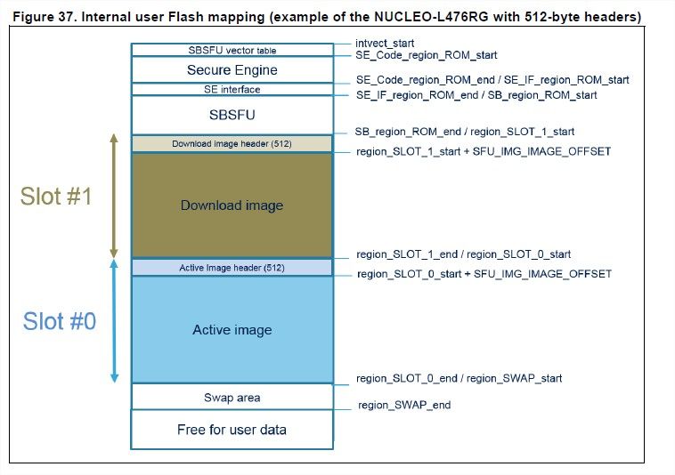

dominik
Senior
@Jocelyn RICARD​
The last free user data part I can delete, or for what is this used?
I changed the icf file to the following settings:
/*###ICF### Set of symbols used in SE and SB_SFU projects ****/
/* Slots Regions must be aligned on 4096 bytes (0x1000) */
/* swap region (4 Kbytes) */
define exported symbol  __ICFEDIT_region_SWAP_start__  = 0x08043000;
define exported symbol  __ICFEDIT_region_SWAP_end__    = 0x08043FFF;
/* slot 0 region (236 Kbytes) */
define exported symbol  __ICFEDIT_region_SLOT_0_start__= 0x08008000;
define exported symbol  __ICFEDIT_region_SLOT_0_end__  = 0x08042FFF;
/* slot 1 region (236 KBytes) */
define exported symbol  __ICFEDIT_region_SLOT_1_start__= 0x08044000;
define exported symbol  __ICFEDIT_region_SLOT_1_end__  = 0x0807EFFF;
/* firmware images regions definition */
define region SWAP_region   = mem:[from __ICFEDIT_region_SWAP_start__ to __ICFEDIT_region_SWAP_end__];
define region SLOT_0_region = mem:[from __ICFEDIT_region_SLOT_0_start__ to __ICFEDIT_region_SLOT_0_end__];
define region SLOT_1_region = mem:[from __ICFEDIT_region_SLOT_1_start__ to __ICFEDIT_region_SLOT_1_end__];
The SWAP area is now 4kB instead of 8kB, Slot Region 236kB instead of 232kb. Usable in the Compiler is 232kB, start in the Map file is @0x08009000, why this 0x1000 (4kB) offset?

dominik
Senior
Hi Jocelyn
What I said is that each time you generate a new firmware update, the nonce file should be changed. Basically recreated with a random.
Actually, if you delete the file, it is automatically rebuilt with random.
-> Yes, with the CBC setup on a rebuild I got a new sfb file on every rebuild. With the GCM setup a rebuild of the application without a change in the code doesn't change the sfb file. Maybe if I rebuild the bootloader aswell, I will try tomorrow, thanks.
About the free user data its clear now, thanks :)
But I'm not sure why the start in the Map file is @0x08009000 and not 0x08008000, why this 0x1000 (4kB) offset? Can you explain this in a few words?
Regards, Dominik

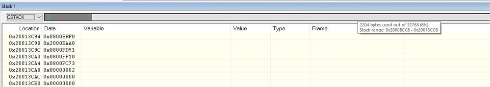

@Jocelyn RICARD​
The project is running now, but I have a HradFault because my Stack is full. Whats the maximum size of the stack which is possible to setup?
In the sbsf.icf file I have the setting from FFF until 1FFF which is 0x1000:
/*                              RAM section                                   */
/* SE RAM1 region protected area */
/* SE stack is placed 1st in RAM, stack overflow does not write on other RAM area */
define exported symbol __ICFEDIT_SE_region_RAM_start__     = 0x20000000;
define exported symbol __ICFEDIT_SE_region_RAM_stack_top__ = 0x20000400; /* Secure Engine's private stack */
define exported symbol __ICFEDIT_SE_region_RAM_end__       = 0x20000FFF;
/* SBSFU RAM1 region */
define exported symbol __ICFEDIT_SB_region_RAM_start__ = __ICFEDIT_SE_region_RAM_end__ + 1;
define exported symbol __ICFEDIT_SB_region_RAM_end__   = 0x2001FFFF;
In the file "stm32g474xx_flash.icf" the stack and heap are defined like in the following lines:
/*-Sizes-*/
define symbol __ICFEDIT_size_cstack__ = 0x400;
define symbol __ICFEDIT_size_heap__   = 0x200;
This setting is too low, but whats the maximum size for the cstack and heap?
I think STM32G474VE has 96kb RAM?
Thanks a lot

dominik
Senior
Hi @Jocelyn RICARD​
I'm talking about the 2Images UserApp stack and the definition in the file stm32g474xx_flash.icf.
The original setting in this file is:
/*-Sizes-*/
But with this setting my own application runs into a hard fault because of a stack overflow. When I change the settings in this file to
/*-Sizes-*/
define symbol __ICFEDIT_size_cstack__ = 0x1000;
define symbol __ICFEDIT_size_heap__   = 0x1000;
the init of my project is running, but as soon as my application is switching to running mode and is doing some work on the processor which needs some variables, arrays and so on, I have again a hard fault... So I changed my functions to improve the stack usage but I'm not able to reduce it as much as no HardFault is generated. Also I use the compiler setting with the highest optimization on size, which is maybe also not the best solution to cover this problem, but without the optimization my code is too big for the 2image bootloader. If there is no other possibility, I have to switch to the 1image solution and check if its working with a lower optimization level, who knows... But the main point is the stack and heap setting in the project. You wrote the available stack is 0x5000. If I use the 0x5000 I need to set this size in the linker file. But do I need to modify the other linker file because of the protected regions? (in the folder linker common)?
Or do I need to modify the regions in the file "sfu_low_level_security.h" in the SBSFU project? I was thinking that maybe these settings are blocking my RAM usage in the application project because of the entries in the "Enable the read/write operation in privileged mode"?
-> Enable the read/write operation in privileged mode for Secure Engine RAM area.
Best Regards
Dominik
Jocelyn RICARD
Hello Dominik,
ok, I understand now. Your application can use the RAM you need. There is no limitation, except the first 4kB.
So, you can increase the stack size to the needed value.
Best regards
Jocelyn
dominik
Senior
Hi Ricard

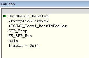

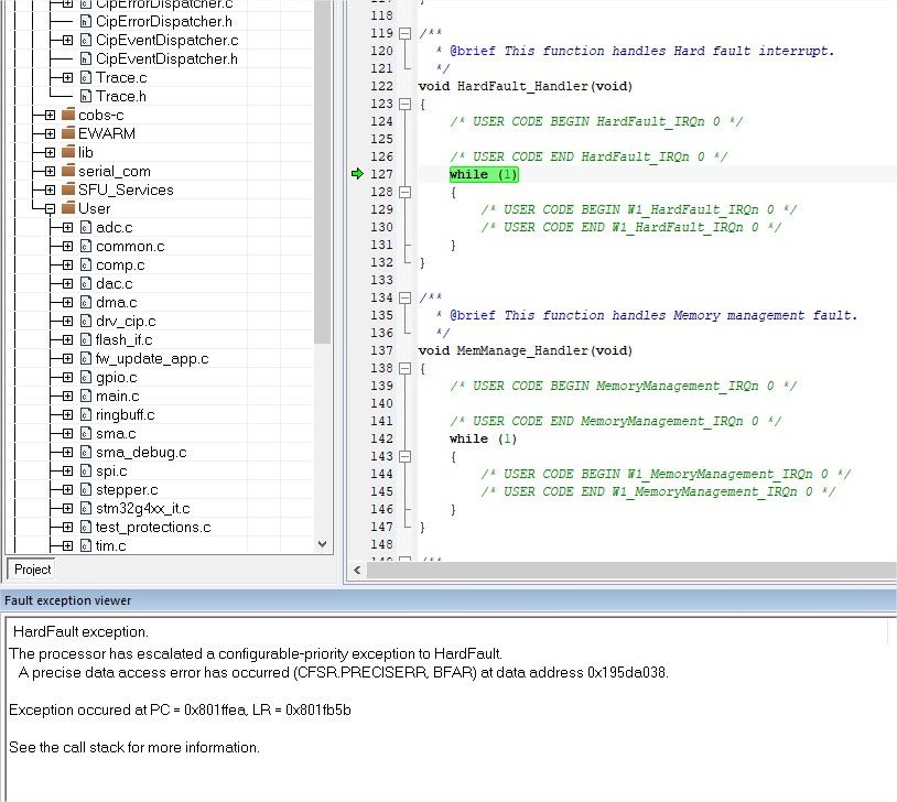

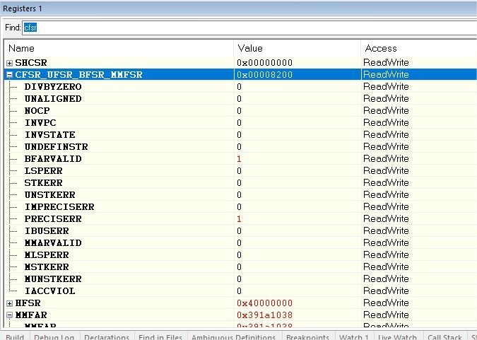

I found the bug. I changed the stack to 0x4000. But still receiving a hard fault.
define symbol __ICFEDIT_size_cstack__ = 0x4000;
This is my HardFault.
0693W000007DYeTQAW.jpg0693W000007DYesQAG.jpg0693W000007DYfMQAW.jpgI found out that I have a problem in the bfsr:
0693W000007DZFKQA4.jpgBut now I know where is the root cause:
I have a UART running in parallel which is receiving a lot of communication. This I check in the mainloop with a ringbbuffer from @Tilen MAJERLE​ .
void CheckUsart1RXMessage (void)
    static data_message_t rx_data;
    if (ringbuff_get_full(&usart1_rx_dma_ringbuff) >= 1)
        rx_data.data_length = ringbuff_get_full(&usart1_rx_dma_ringbuff);
        -> This causes the ERROR!    ringbuff_read(&usart1_rx_dma_ringbuff,&rx_data.data_a, rx_data.data_length);
        //rx_message_f(&rx_data);
When I disable the "ringbuff_read()", the HardFault is not happening anymore. If I enable the function, the ST is running until my statemachine gets running -> I gues a stack overflow or something like this.
