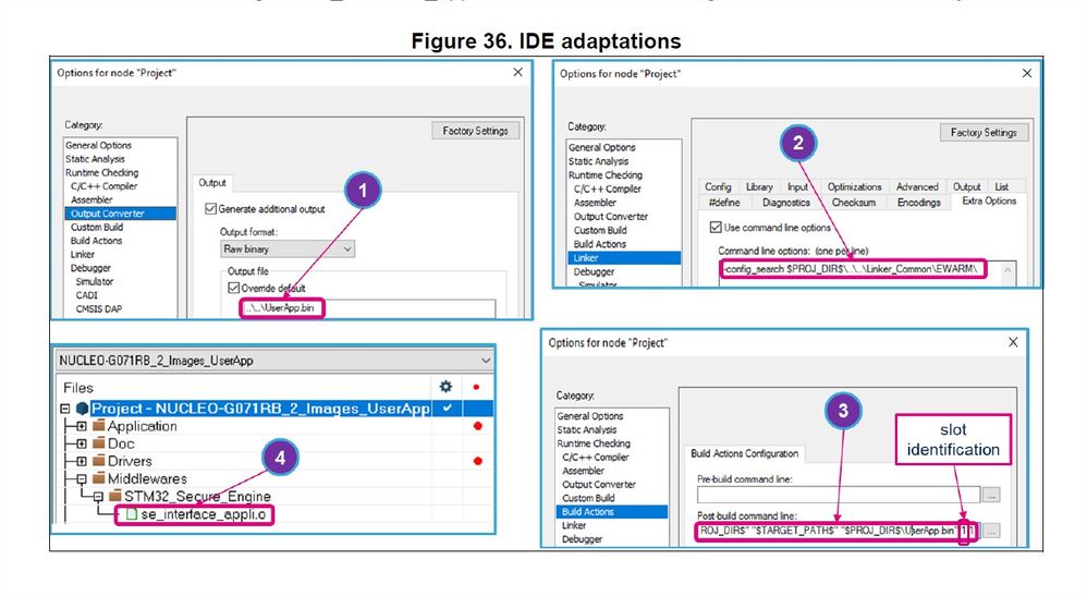

0693W000007CsHcQAK.jpgHi @Jocelyn RICARD​
Thanks for your answer, yes, all clear now thanks. You are talking about this node like in the picture, right?
Like I understand, I need change this node everytime when I generate a new GCM key for a Bootloader/Application, right?
The Startup-Time is shorter yes, about 2.9s now, before was 4.038s, but without log it seems to be longer
Thanks a lot, Regards, Dominik
