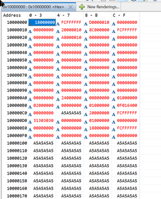

To work out what a program requires, fill the stack and heap with an "0xA5" pattern by:
int main(void)
	/* Initialise DTCM_STACK 	 */
  #define DTCM_STACK_START ((void *)0x10000000)
	memset((void*)DTCM_STACK_START, 0xA5, 1280);
Run the application and use the memory browser to examine the heap and stack to see how many of the A5 patterns were overwritten.  Of course you must ensure all of the code is covered so that all possible heap and stack uses occur.
In my case I started off allocating 2k for the heap and 2k for the stack. After checking the usage I found I only used 64 bytes of heap and 336 bytes of stack.  I set my heap to 256 and the stack to 1024 (1k) which saved me nearly 3k of ccm.  I could have gone smaller, but it was a relatively small project and ram wasn't at a premium.
So the trick is to start with some conservative, larger values for the heap and stack and then if you are running out of ram or you want to pack more globals into the ccm for a bit of extra speed examine the stack and heap and adjust accordingly.
