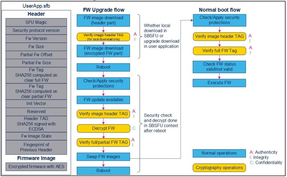

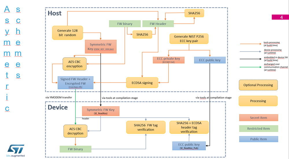

@Fred​ I cam to know that is the Metadata Header also signed ??
Step 1: Compute HASH of Firmware application and Sign with ECC.
Step 2: Store this Signature in Metadata Header.
Step 3: Then fill remaining Header fill with '0's.
Step 4: Then Sign Metadata Header as well ?? If it is, can we verify with same Public Key ??
Can you please clarify on stages of signing involved in SBSFU, without Firmware encryption ??

sorry for the late reply, I was on holidays.
The crypto scheme is like this:

By default is this is the signing mechanism we follow or Do we configure to SIGN alone metadata header with SHA256 of Metadata Header.??
Looks to me, we compute SHA256 of Firmware, add this TAG in metadata header and sign Metadata header from example. is this correct ??
‎2022-09-01 10:05 AM
This is correct. This is the signing mechanism followed by the software.
Both tags are checked during the update:
