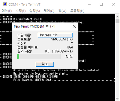

I'm porting my project(sbsfu Nucleo-h753zi to Nucleo-h745zi-q)
and i checked protection my board, but i can't full chip erase.
./STM32_Programmer_CLI.exe -c port=swd mode=UR -ob PROT_AREA_START1=0xFF PROT_AREA_END1=0 RDP=0xAA

and when i send UserApp.sfb using ymodem. stoped the 1024kb

‎2024-04-09 7:05 AM
Hi @yolominwoo,
to remove the PCROP protection, you need to perform regression from RDP 1 to RDP0.
Program the RDP to 0xBB, then program the new (empty) PCROP along with 0xAA to RDP (both simultaneously). What you encountered is normal part of the PCROP protection, protecting the hidden code even in RDP0.
BR,
J
